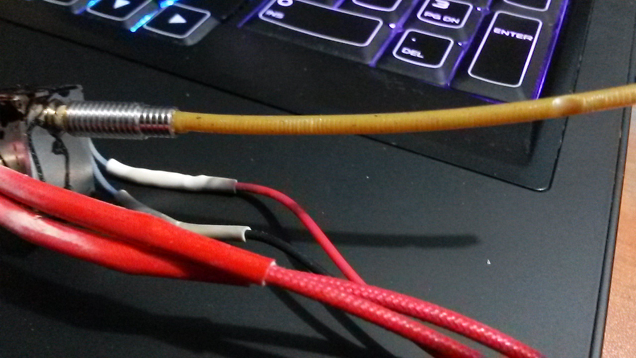

is your E3D Jammed?  I took it apart, and unscrewed the heatsink.
is your E3D Jammed? I took it apart, and unscrewed the heatsink. I ran a hot 40w soldering iron along the threads for a couple of minutes and then I was able to easily pluck the jammed filament out easily.
