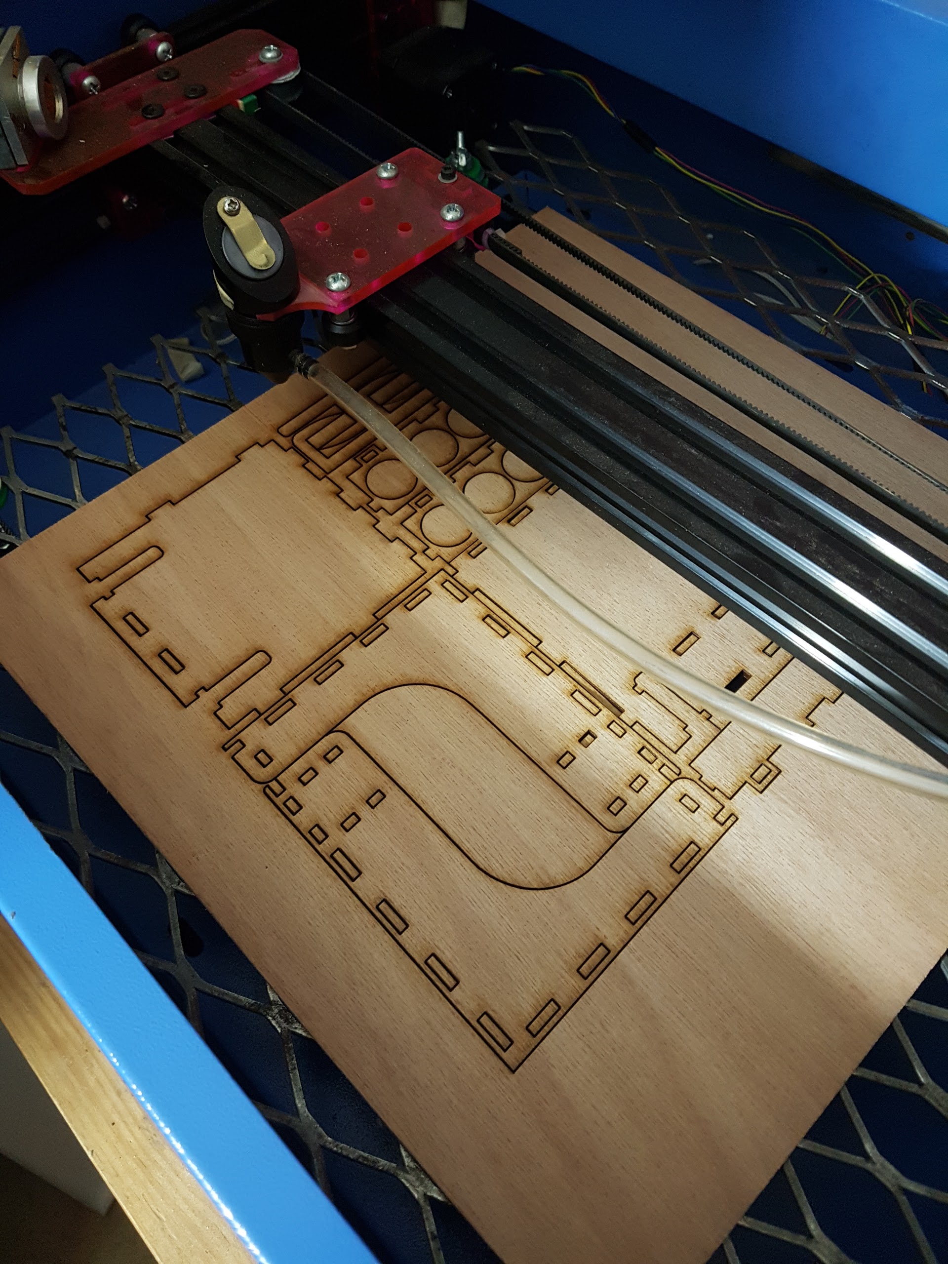

Isn’t it lovely when you have a full operational laser cutter?
#UK40OB
OMG brother!!! Back in business!!!
I want one!!!
Very nice! Is that a little PIcade?
@Michael_Audette a small organizer
Niiice. Do you have your gantry design drawn up anywhere? Your custom acrylic lens and mirror plates look great too. I’d love to check out the build.
I think it’s on thingiverse look up uk40ob
also: I’m curious how you solved alignment of the #1 mirror (the one next to the tube) to the #2 mirror on the gantry. With that shelf completely separate from the gantry, isn’t alignment still a pain in the ass?
@Bob_Buechler No pain at all. Just need to make sure its all in the same plane and i did that by having the side rails attached to the side panles of the case and adjusting height as needed.
@Bob_Buechler you can find more info here
http://www.openbuilds.com/builds/uk40ob.3988/
@Ariel_Yahni_UniKpty Re: “i did that by having the side rails attached to the side panles of the case and adjusting height as needed.”
Interesting. I think I understand. When you have a sec, could I see a picture?
#UK40OB click this youll find also more info
