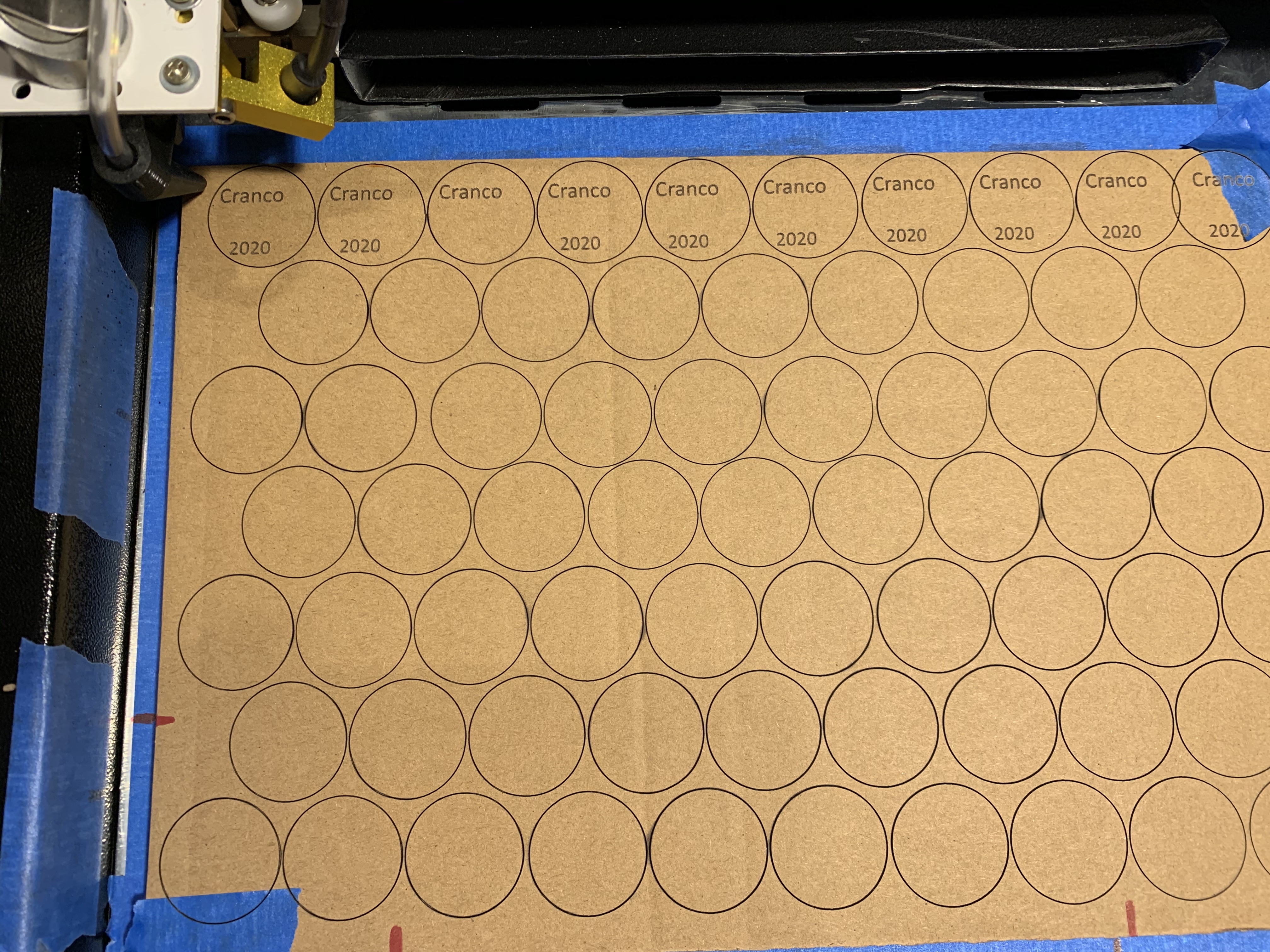

I created a template in Inkscape that was rows of circles with a little text inside that I plan to use to engrave small coated metal tags. The thought was to burn in the circles on cardboard and lightly engrave the text to ensure alignment. Then I would lay the tags inside each circle and engrave each.
When I lightly cut the circles onto cardboard one in the top right overlapped another, although my image file does not have them overlapping…
Next I lightly engraved the text and the alignment is off. I double checked the imported image and it’s not off, so why is the laser not aligning the elements of my project?

Thanks for the replies guys. The belt seems pretty tight but I will research checking them properly and adjusting if needed. I have attached a picture that shows 3 things. First in the upper right you can see the two circles that overlapped, although my original file has all circled spaced evenly. Next you can see the text is off center although again in the imported file it’s all centered. Lastly I just noticed that in one circle it didn’t mark the year 2020. All this is very odd to me.

Also make sure the circles on the end at the right are within the work area that the head can reach. There are no endstops on the right so if the head tries to move to far to the right it will hit the rail and the belt will skip teeth. This would cause all subsequent actions (where there is no rehome) to be shifted.

So I did another test run for this project on cardboard to see if the alignment issue was still there. This time it’s all aligned properly. I don’t know what happened last time, as I recall I had the work piece taped down from the start so I don’t think it moved during the job. Who knows, if I see this again I will dig in further. Thanks for the responses everyone!
OK Ned I understand now what you said if the object is out of the work area. I was about to post a new topic with this image since there is an alignment issue here as well. (all boxes in the source file are aligned perfectly) I did hear the belt skip once during this job so probably that is what happened. I think I will retry this job with less boxes and make sure all are well within the work area and hopefully it corrects the issue. Just an update I guess.
