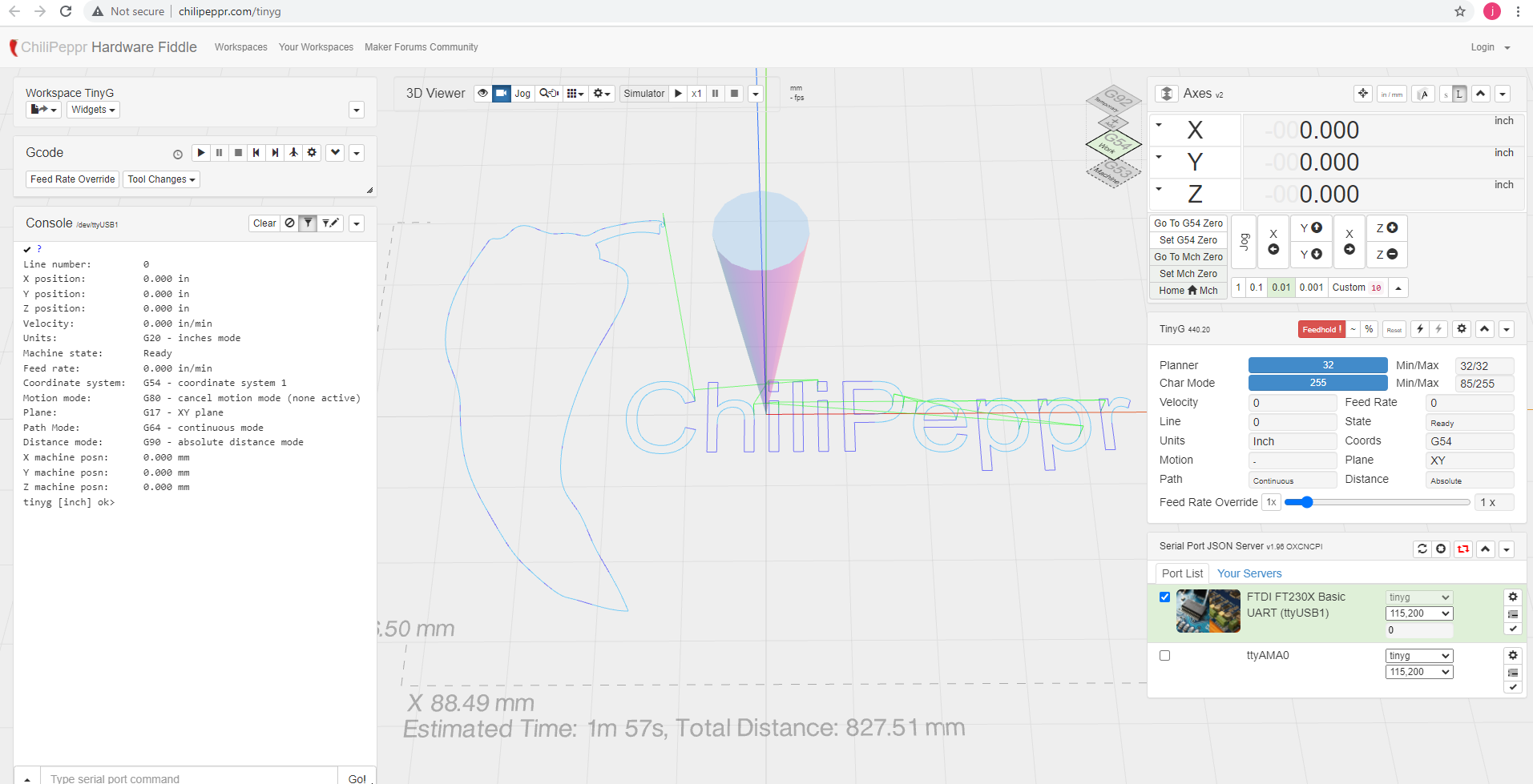

Hi, looking for some help regarding an issue I recently encountered while trying to home my OpenBuilds OX CNC. I’ve run this machine for years using ChiliPeppr with an RPi 3 Model B running SPJS and suddenly, the machine will not complete the homing process. Instead, if I have flushed the queue and set the machine to zero every time it stops and retry, it will move until it arbitrarily stops at specific location: when homing the X, it will stop when the X-Axis readout reads -22.394 inches; when homing the Y, Y-Axis readout is -29.394 inches. Also noteworthy is that that actual distance traveled is not the same (i.e. the X-Axis will move 1/2 inch, and then 3 inches, then 1/4", etc.) but it always stops when that readout is -22.394 inches. It seems to run normally when I feed it some G-Code to air cut.
