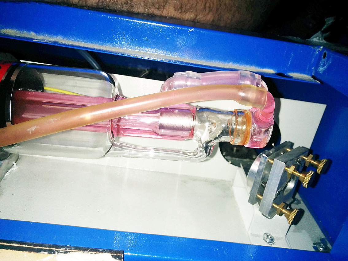

Issues with the new tube :| So below is a pic of the tube
Issues with the new tube :expressionless:
So below is a pic of the tube I’ve received from eBay seller reci-laser (not sure if they’re affiliated with reci).
Here is the advert: http://bit.ly/200i1LO
As you can see the designs are completely different, in fact this tube is different than all the tubes I’ve previously seen… Now as per my other post I have a strange issue with very fine bubbles. The problem with this tube is there’s a ridge where it tapers, this captures the fine bubbles, they accumulate and make big bubbles.
Now to be honest, I usually wouldn’t care what the tube design was (unless this was a proven inferior design) but this design is exacerbating my fine bubble issue. It looks inferior to what’s advertised…
As what I’ve received differs considerably from what’s advertised I’m think of contacting seller to complain, thoughts please. :slight_smile:
Am I being unreasonable?

The bubbles are so fine that I’d say they wouldn’t be an issue if the tube was like my others ie it didn’t taper in, which has caused a ridge that traps them. My next test is to swap the pumps over just incase that’s somehow causing them.
Have people seen this tube design before? Also am I being unreasonable thinking I should have got what was pictured in the advertisement (ie metal cap, non tapered)?

The design is similar to design B in this reference pic: http://bit.ly/1qq8nWB
The glass tapers back in well before the tubes ends. Where it tapers is a ridge and the fine bubbles trap there. As said before if the tube was the same design as my previous ones I’d most likely have never noticed it!
