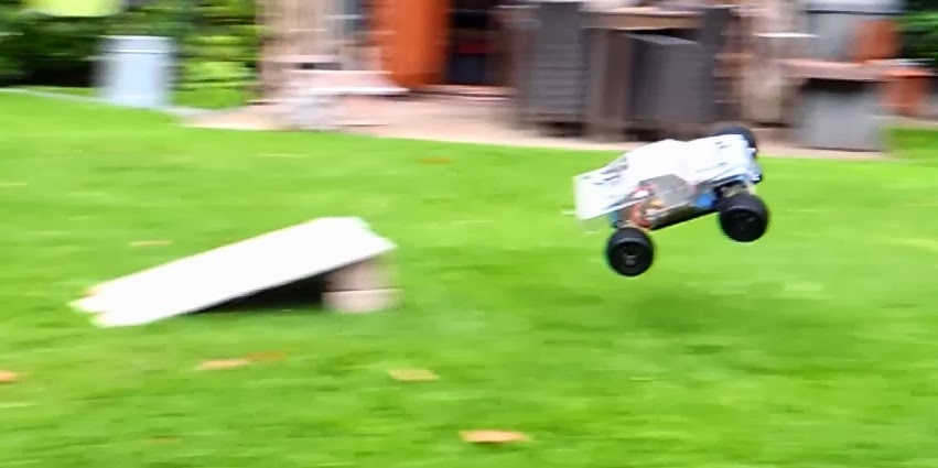

It can fly...and break nylon wishbones. Sorry for the blurry action shots.
It can fly…and break nylon wishbones. Sorry for the blurry action shots.
@Emile_Wim Awesome! Sucks breaking the wishbones but when you think about the fact that your car in the pictures is actually 3D printed it’s crazy!!
Would you mind sharing some photos of broken wishbones?
The left rear wishbone broke after about 10 jumps, but it was great fun, my daughter was driving. :slight_smile: The wishbone split (delamination) at the hinge (diff side), i’m still printing it laying down. Upped the temps to 260 and switched to taulman 645 now, if it still breaks i’ll print it standing on its side.
