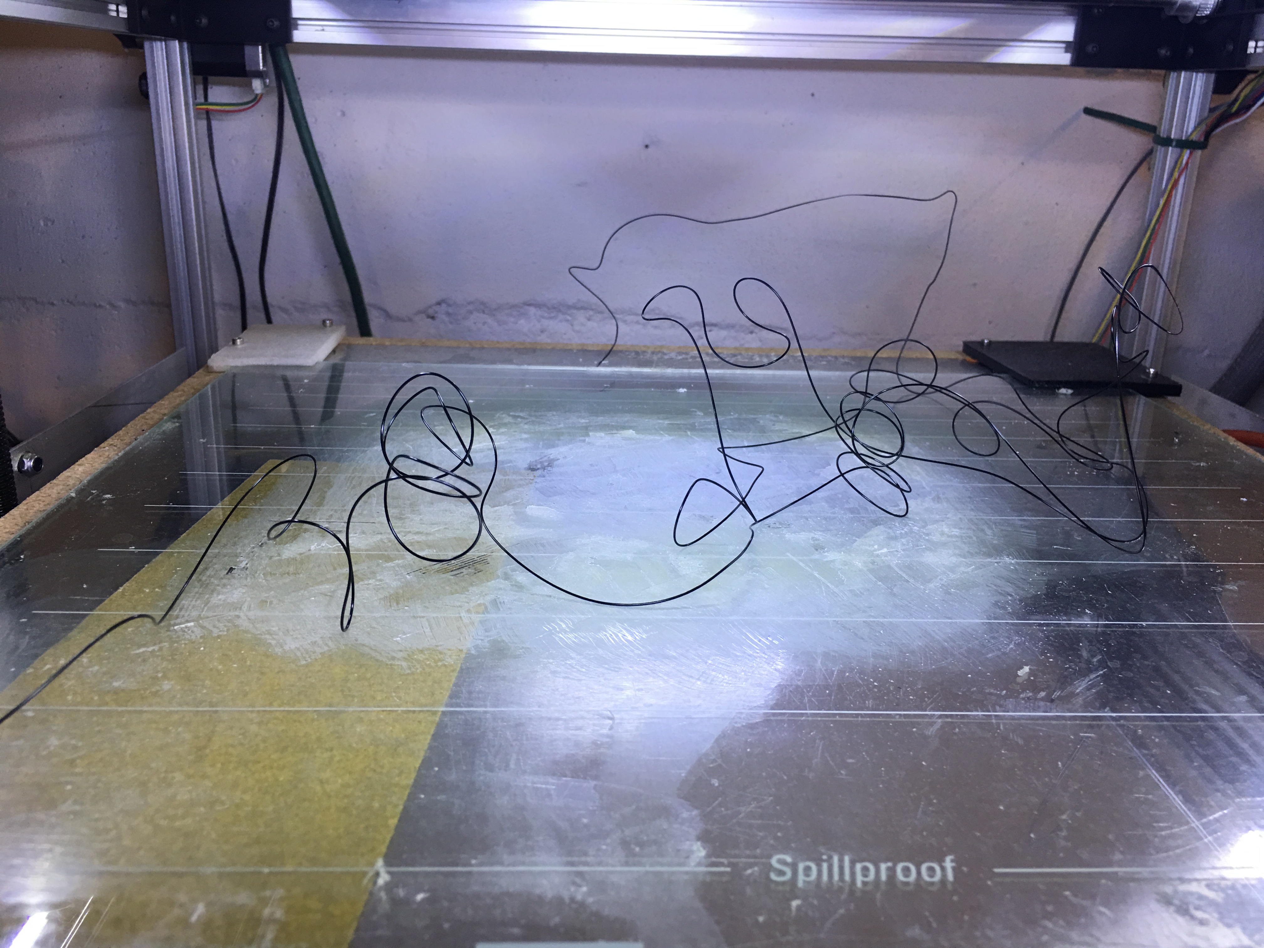

It does not look pretty, but I have the new Bondtech BMG mounted and stepper motor wired in. I Think this is the smoothest unit I have experienced to date. I need to figure out the steps to put into the Smoothieboard configuration, but the second picture shows a nice long run of melted plastic, so I am excited.
