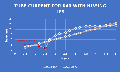

Attached is the profile of control voltage vs current for my supply.
I am carefully evaluating the conditions of this machine as I bring it back to normal with the hopes that I will take away some data that would allow us to practically sort out a bad laser tube from a bad supply.
My working theory has been:
If the supply is bad and the tube is good the control voltage vs tube current will be abnormal in these ways:
  • Nonlinear
  • Intermittent especially at high control voltage settings
  • Low power (no way to measure yet)
If the tube was bad and the supply was good the control voltage vs tube current would be:
Linear
  • Linear as compared to the model
  • Lower than normal current values at control voltages as compared to the model.
The Attached Graph
The orange is the “Ideal” Model profile as taken from the analysis of @NedMan 's new tube and LPS. That model was used to calculate an ideal curve for my machine using my control voltages.
The white curve is the data that I measured at the machine using the dvm on the pot and the laser current meter.
Observations:
  • For control values below 1.5V the Tube Current is abnormal and the supply hisses.
    • Note that the lower end currents are near the lower ionization levels of the tube i.e. 4ma.
  • After that point the LPS operates above normal until about 4.5v at which it outputs higher than the ideal model.
  • If the LPS had a bad HVT that was breaking down I would expect the current at the higher control voltages to be less. These results suggest the opposite.
  • These results indicate that the supply operates HOT between 1.75 and 4.25v but that the supply can support a load near normal at max control voltage.
  • Why is the tube not ionizing sooner as the model would suggest. Ionization (tube current >4ma) should occur at around a control voltage of .7v. On mine it is somewhere between 1.2 and 1.5vdc.
  • Why does the current drop to 2ma at 1.5 on my machine?

  • Is it possible that at low control voltage the tube is not fully ionized because it has not reached breakdown. It is not providing much load (4ma) and therefore the HVT sees a higher voltage and hisses (corona just before breakdown)? At these low levels the tube is not ionizing and therefore the firing voltage is high for a longer period than when the laser full ionizes and rapidly drops to its lower voltage and higher current.
  • Could be that at 4ma (pre-ionization) a normal LPS will hiss? @NedMan can you check on your machine?
Yes at less than 4ma there is some hissing not present at higher currents.
Thank you… so perhaps hissing is not a good indication of a bad supply.
