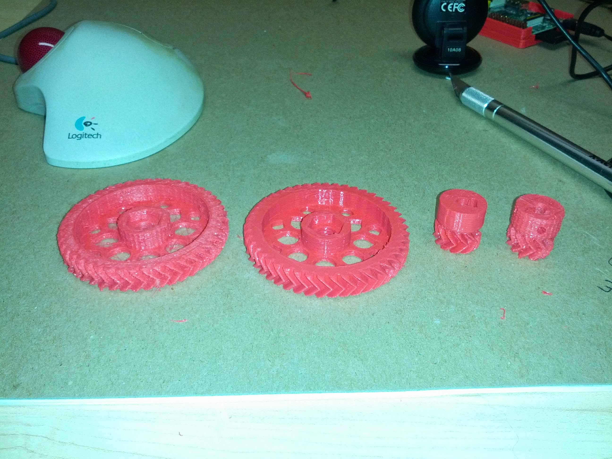

It is amazing the difference that the firmware on your controller can make. I finally got Marlin working (was using Sprinter in the past) on my MakerGear Mosaic. The difference is clearly visible. The gears did not work at all before, and now appear to be quite smooth. No other changes were made to the GCode. For those of you starting out with 3D printing, I suggest looking closely at the firmware you are using and updating to a more modern version.
Wow that’s a huge difference.
My buddy just changed out his and it made a world of difference. Also MakerWare made huge leaps in their last update. Great job on the prints.
@Mark_DeNeve I agree 100%. When I built my printer I used sprinter as well and I was having a serious issue with the X axis. When telling it to move out 100 mm and then back 100 mm it never returned to the same spot twice, it would jump all over the place plus it made the motor sound like it had sand in it. I tried switching out motors and drivers and they all worked fine on the other axis just not X. I was about to get a new ramps board thinking that was causing the issue when I decided to flash Marlin to my board and that fixed the problem. All axis worked beautifully. It definitely helps to have the most updated firmware.
Wow, I planned on going with Marlin (if I ever finish a printer), and apparently I made the right choice. It looks like you put the Sprinter ones in the oven!
