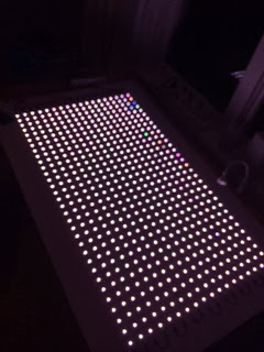

It lives! 576 pixels and a maximum so far of about 110W (measured at the wall)
And, having left it on like this running full-bore for ten minutes I see some smoke coming out of something. BRB.

A couple of odd colored ones but otherwise it looks great. Hopefully you didn’t burn anything.

Are the weird looking pixels in the picture related to the fact that they are burnt or just a visual anomaly? /fingers still crossed/
Half maybe some kind of power flakiness and half exaggerated by the camera. I’ve had it on for about half an hour now and it’s all a nice even white and nothing is on fire. Gonna chalk that up as a win.
