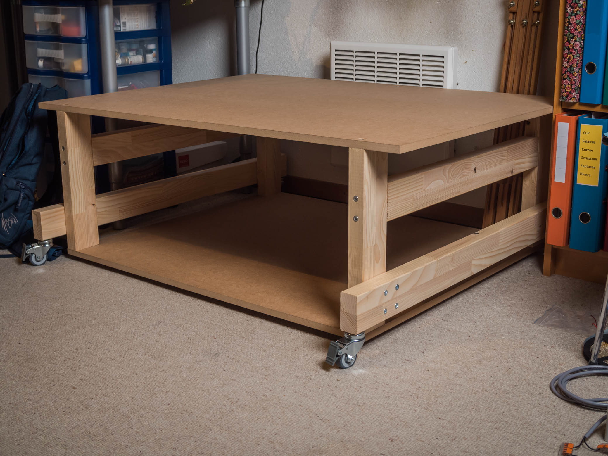

It looks like I’m ready for the beast
Looking good. Cant wait to see the before and after

really nicely done. Im starting to think your FabKit might be better assembled than ours!
I might just have to steal this design for my table, nice one @Maxime_Favre
Can share CAD files if needed.
@Maxime_Favre I probably need to adapt it a little to fit into my space. But I like how you’ve done the wheels. That saves a lot of height. What are you using to switch the chiller and fan on/off? Been searching for some proper switches, but most don’t allow that much current …

I am ready too. Tight fit but it should work
Looking good
