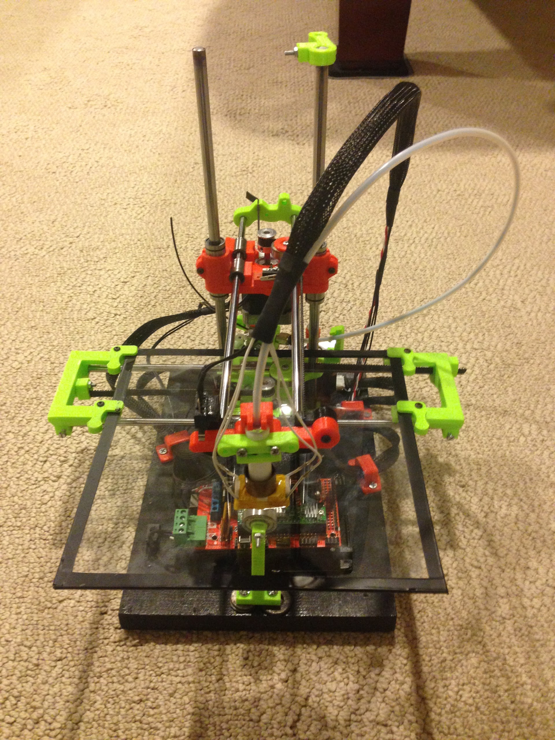

It might not look much different but all the endstops, the thermistor, and the heater wires have been redone. The wires for the endstops and thermistor used to be small 6 inch strands soldered together but now I have nice silicone stranded wire as a replacement. The heater wire is still the solid strand as I felt it needed the connection and is used as the skeleton of the wiring. I didn’t have enough mesh to cover all the wire but I have it on order and in my opinion even the little bit that I did cover on those wires looks a heck of a lot better. Also all the wires aside from the heater and motors are now black as they do not have any polarity. They are all also labeled as they were before. I think it looks like a much cleaner setup. It will be completely reprinted in either yellow or black within the next week. It depends on which color PLA I can get to work better. Stay posted for updates including an LCD!!

What’s the built size?
Microsteps? 1/16, 1/32…?
Thanks
Build size is odd at 190x190x130. But a cm loss due to miscalculation on y part doesn’t bother me too much. I have 1/16 microstepping and it seems to be working well. Might switch to 1/32 to see the difference but that would be a ways in the future.
