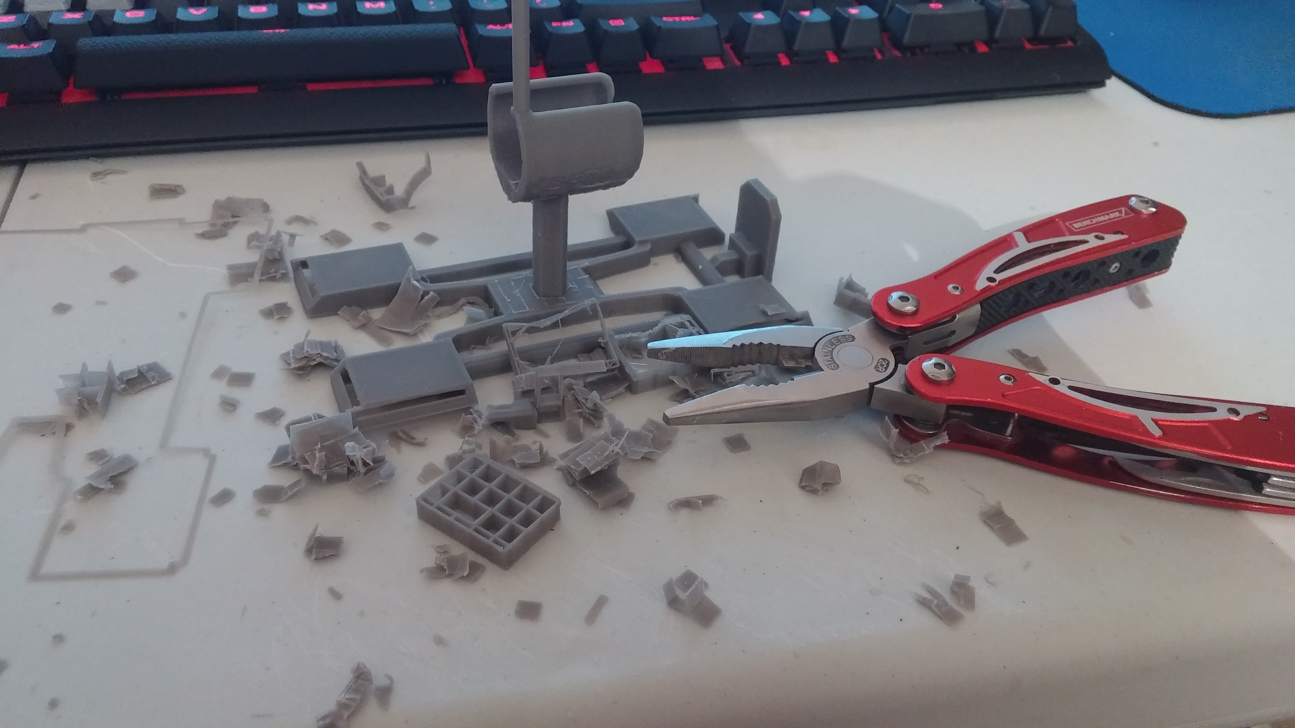

It took me 1 hour to remove the grid support from my 6 hr
It took me 1 hour to remove the grid support from my 6 hr print object!! I meant to put lines but i guess i miss clicked it.
