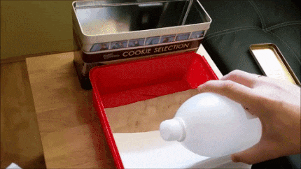

It took us a while to find a right container for ABS acetone smoothing. Blog: http://3dwithus.com/abs-acetone-smoothing-filament-review

@Chris_Bigpaws_Chambe We failed once when we used a normal jar. Vapors stayed low and melted item too much while top wasnot smoothed enaugh.
