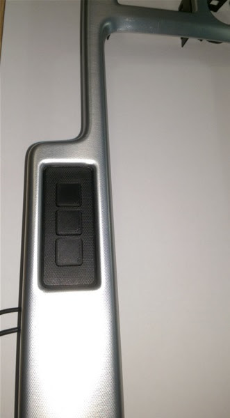

It turns out my Volvo supports the bluetooth headset protocol but not the bluetooth stereo protocol, this is fine as I could use the 3.5mm audio jack but it meant I couldn’t pause or skip the music without picking up my phone.
So what I did was 3D print a set of headset controls which directly swap in place of the coin holder and plug in between the phone and audio in on the car.

Very nice job on replacing the coin holder, that looks perfect.

@Mike_Kelly_Mike_Make yes absolutely identical. Basically play/pause is achieved by shorting out the microphone pins and forward and back are shorting out via different resistor values.
@John_Helmuth I used these values with my HTC One Android Phone; http://i.stack.imgur.com/1MWRM.jpg, you basically connect them between ground and the mic pin. The only other thing I had to do was simulate a microphone (I used a 10k resistor) for when none of the buttons are pressed. Ahh here you go https://hackadaycom.files.wordpress.com/2010/11/android-phone-control-cable-hack-e1288798989436.jpg?w=470&h=284 I think thats like what I did. This is missing the microphone simulator resistor though. Without that my Android phone presumed you had headphones not a headset and ignored the controls.
