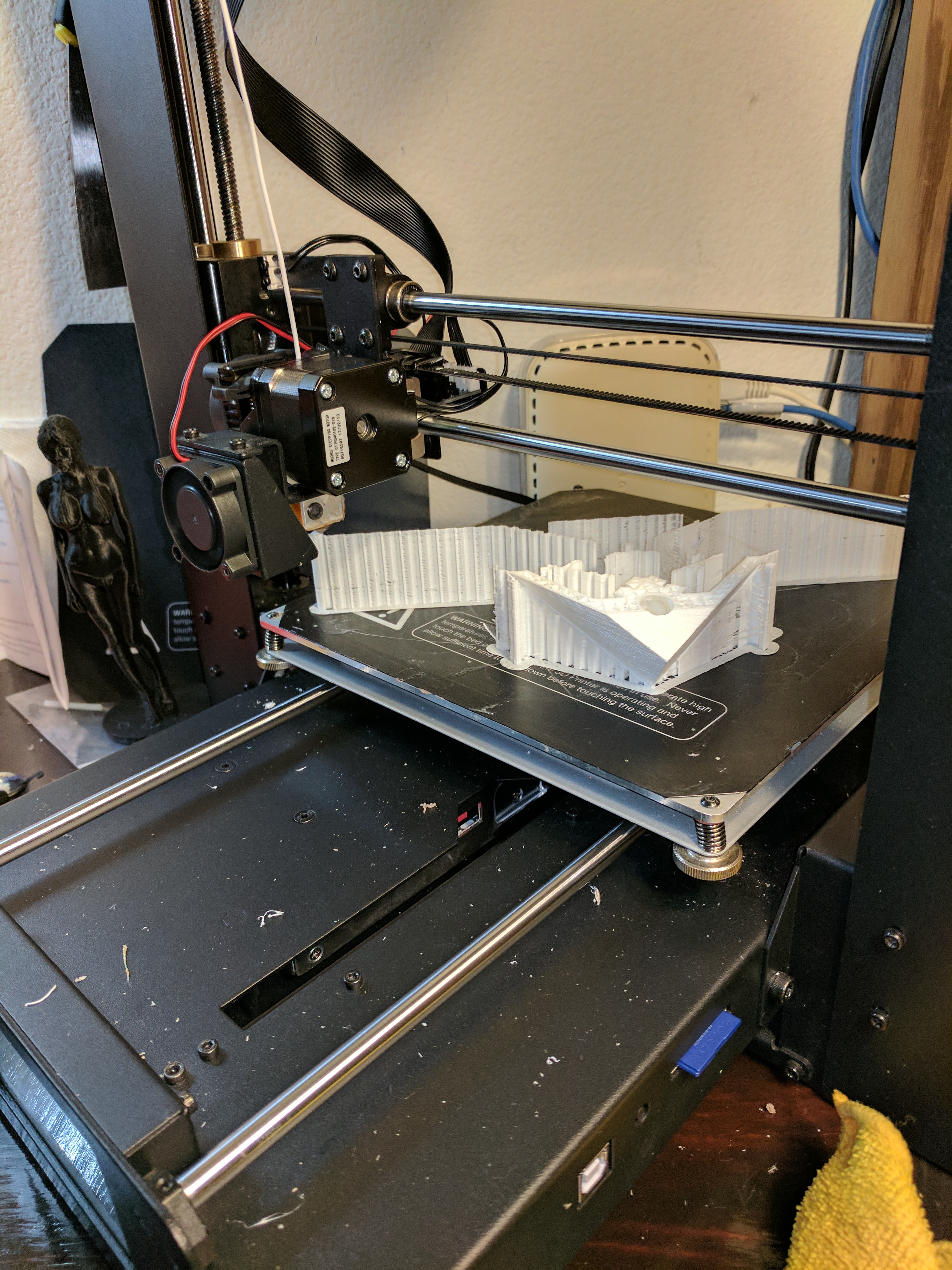

Iterating on the XY motor mount and brace. Given my FDM/CAD skills are quite recent, and this is the largest and most complex object I have designed and printed, if this works I will be overly impressed with myself.
One in a series of iterations…

Curious why you’re printing up on a corner during design iteration? I can see it for “final” parts to get the layer lines in a good orientation, but it’s an awful lot of supports for a prototype
Even if it would be the final part, the layers are oriented in the completely wrong direction if I understand the design correctly.
I would have printed it flat on the bed. But I would also redesign the part a bit. There is probably no functional need for the motor recess. So you could just add some big chamfers and remove the counter “bearing”. Which is, without a ball bearing and with this layer orientation ,pretty much useless anyways.
Maybe it’s also a good idea to consider the Aluminium extrusion as a contact area for the next extrusion instead of a plastic part. This will always lead to a stiffer connection.
I really like to see if people try new ways. Even if it’s maybe not the final solution, it leads to new ideas. But sometimes it simply doesn’t make sense to reinvent the wheel
First the corner cubes really need to be printed in this orientation. Cleaning out support structure from the complicated side of that structure would not be fun. Any leftover bits would mess with fit.
Second, tilting up allows a larger brace to be printed on my printer. It might be excessive, but I like a larger diagonal brace. As it is, this just barely fits.
Third, in one of the earlier iterations I had a bridge that wrapped around the extrusion to support the end of the motor shaft. In this orientation I can (and did) print that bridge without supports. Left off that bridge in this iteration. Might be excessive. Might add it back later.

The print completed, and the part works, but I did miss a few things, as might be clear from the picture. Corrected, and printing the next iteration.
You have some serious underextrusion problem.
@Pjotr_Lengkeek Yes. For quicker iterations, printing at 150mm/s (and 20% infill). This is the maximum rated speed of the printer … and perhaps a bit optimistic. For now, the prints only need to be sufficient, not pretty.
I expect to slow down the printer (and use higher infill) for the final prints, once the design is settled.
