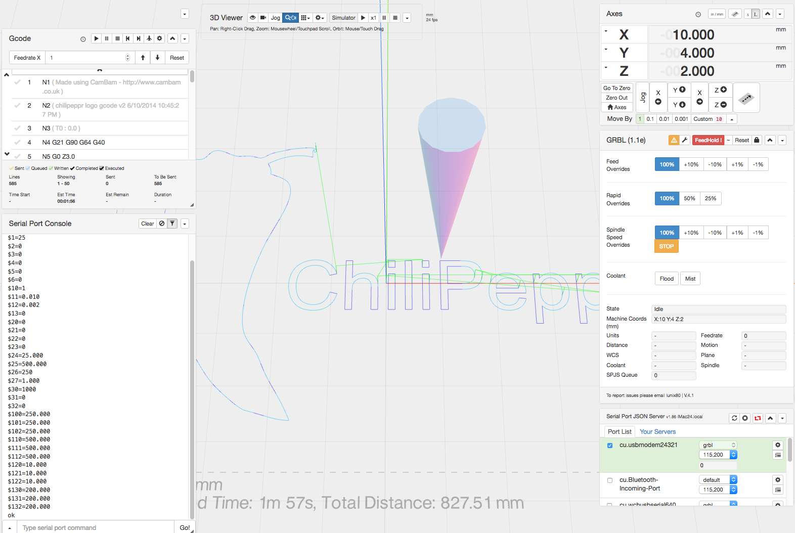

I used part of your code anyway. A preview can be found here http://www.lunix.it/grbl/workspace.html?forcerefresh=true but I have to fix lot of things…

Preview: http://chilipeppr.com/grbl-v1 the workspace is onb github, next i’ll upload to it also Serial Console widget and grbl widget…

Hi guys, FYI i have updated the spjs widget to include support for the Arduino Mega board ( mine is running grbl 1.1e ) in the following pull request :

Uhhmm I’m getting strange error: Error: Load timeout for modules: inline:com-chilipeppr-widget-grbl
