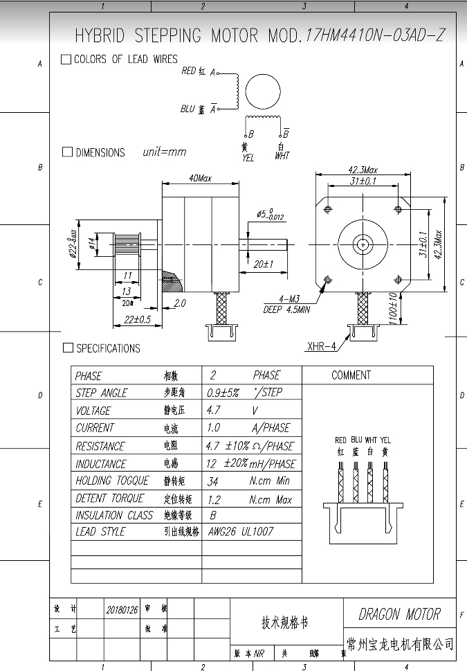

hello sorry can you give me the initials of the nema17 you used instead of 17hm4410n?
17hm15-0904s Note that it is not dual shaft like the original!
thanks for the immediate answer I wanted to ask you instead an alternative to the engine of the x axis?
@Camarda_Neon_Salerno no sorry I only looked into the Y motor since that one was broken and needed replacing.

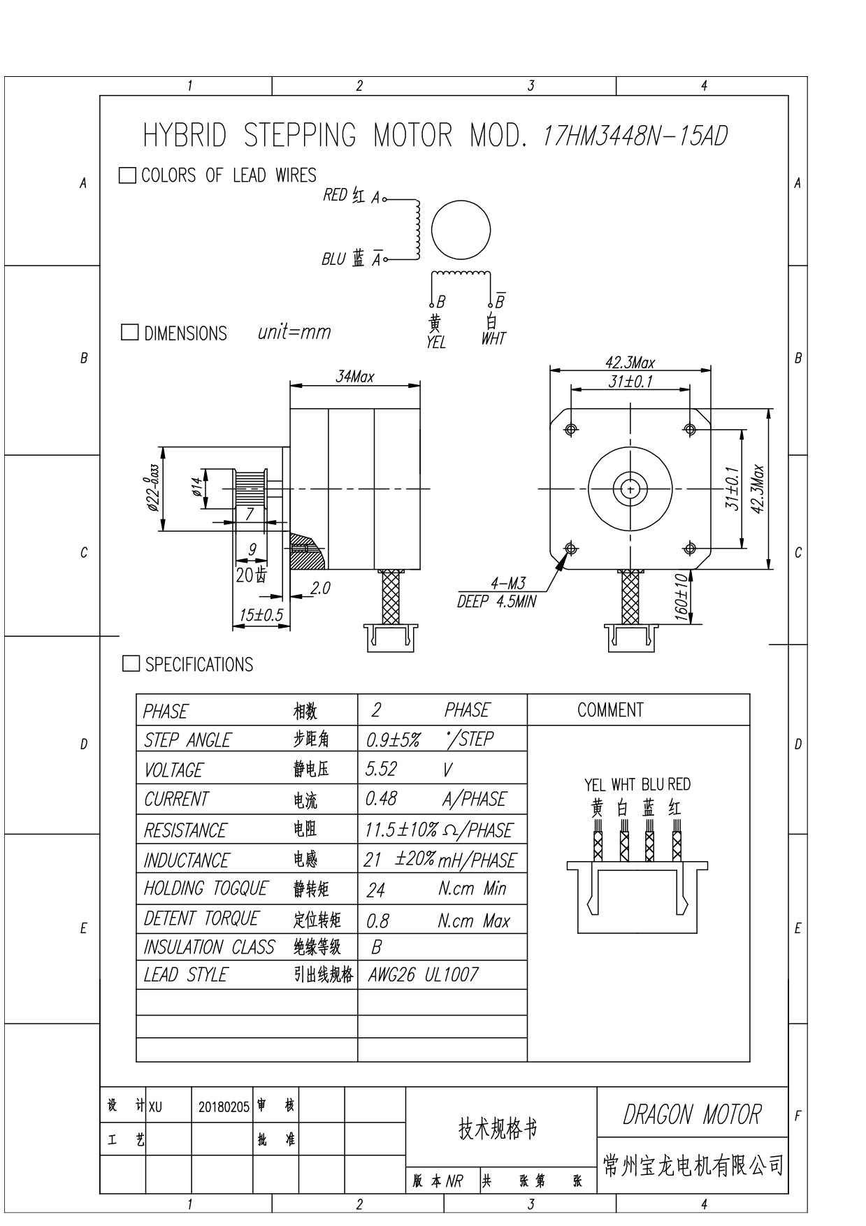

I contacted the baolong motor and they sent me the engine datasheet x but I can find a substitute I’ll link the pdf maybe you’re more than capable of me
I’m no expert, so this is without any guarantees, but it looks like this would be compatible for a straight swap: https://nl.aliexpress.com/item/Free-shipping-NEMA17-0-9degree-42BYGHM381-42HM40-0404-42mm-2Phase-Hybrid-Stepper-Motor-12V-0-4A/32568721527.html
