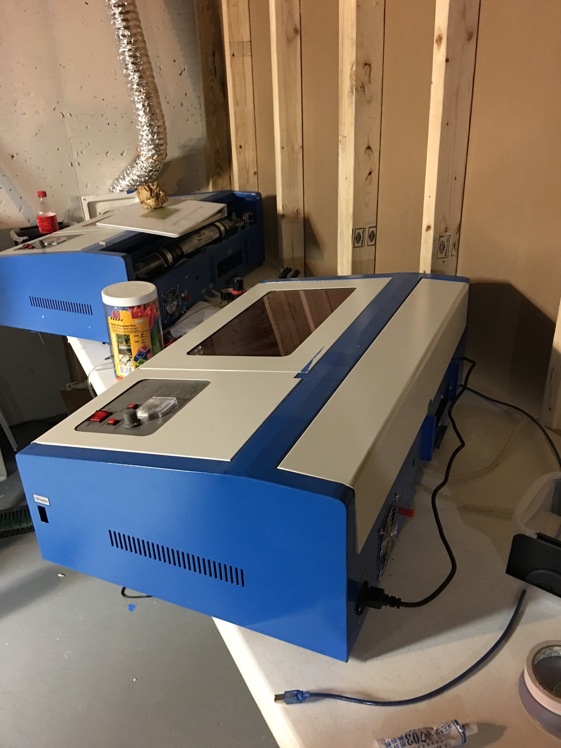

It's ALIVE! Turns out my power supply was fried.
It’s ALIVE! Turns out my power supply was fried. Got a new machine for parts and now I am back in business

Honestly I would love to slave the second machine to the same board so that they are mirrored is it possible to split the signal coming from the board to two different machines
@3D_Laser We recently had a similar discussion on another post (can’t recall which one) & if I recall correct “I Laser” mentioned something about using 2 machines from the same computer, but had to use a virtual machine to run the 2nd machine. I’m think it may be possible to run both machines off the same board, but I’m not sure if the board would be capable of powering both machines correctly.
In a perfect world it would work, but in reality, the endstops would be braking it. you would have to use custom electronics/software.
@Yuusuf_Sallahuddin_Y ​ I was following that post it requires two instances of the software because of the two boards were identical and required the dongle or something like that to run I remember reading if the main boards wernt identical it would be possible without VM ware
If you upgrade it to a Smoothieboard, or Ramps/Marlin, you can run as many machines as you want using LaserWeb
I think this should be straightforward. You can use a slave controller to drive the motors of both units from the same motor signals. You can hook up ssr"s to split the beam enable in a similar way. You would just have to home one of the cutters manually. http://reprap.org/wiki/Build_A_Stripboard_Bipolar_Slave_Stepper_Controller
