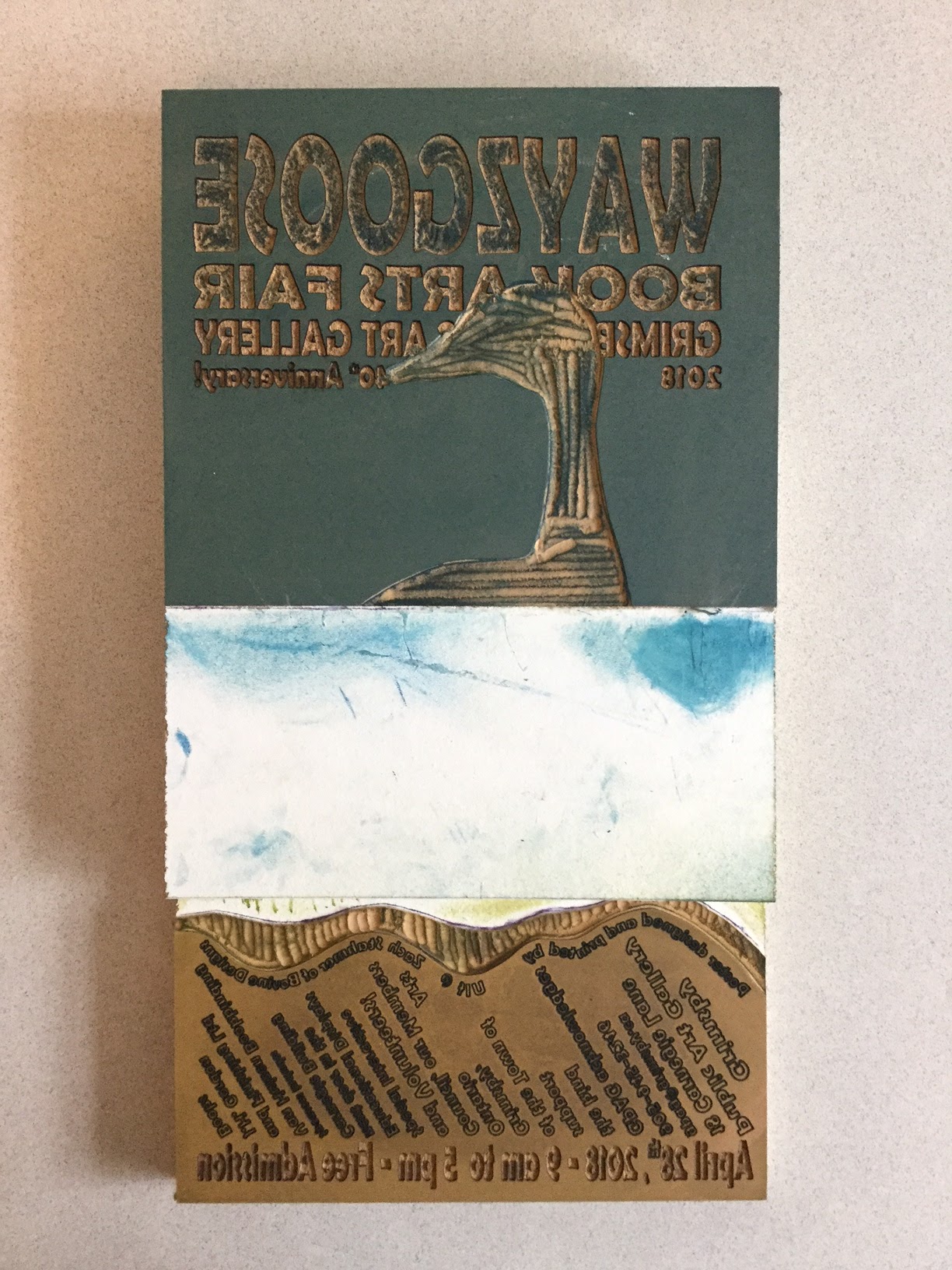

It’s been a while since my last post, so I thought I’d share a recent project that has a bit of a twist. Recently, I volunteered to print the poster for the 40th anniversary of a local(ish) book arts fair, Wayzgoose held in Grimsby, Ontario. http://www.grimsby.ca/Art-Gallery/Wayzgoose/
As my selection of lead type is limited to small font sizes, I thought that I would use my K40 to cut the text for the poster into lino blocks and print them on my press. All things considered, it went very smoothly. Initially, I wanted all the text to be white (like at the top and bottom of the poster), but I discovered that while peeling out the inside shapes (after a laser cut of the outline) it was difficult to not to remove the floating shapes in the letters (such as the center of the o). I didn’t really want to raster-engrave out the letters, because if the engraving wasn’t deep enough, any remaining linoleum would cause artifacts in the print. So I decided to try a test print with just the laser cut outline on the smaller fonts, and I liked it! As can be seen in the photos, where required, I removed some excess linoleum by hand.
Overall, I’m very happy with the way the K40 cuts lino. I made sure that the small text was cut with an unfocused laser beam to give the outline some thickness. I will definitely use my K40 on these projects in the future!

@Yuusuf_Sallahuddin_Y I had read somewhere, perhaps even on this forum, that natural linoleum was safe to cut. I purchased the linoleum at the local arts supply store. I believe that it’s made in Germany. I have seen it in two colours: brown and grey. Both have the burlap backing.
I used 40% power and a speed of 600 mm/min in Laserweb. As mentioned, I purposely used an unfocused beam for a wider cut. Just cutting the outline results in a faster cut than engraving.
The biggest challenge I had was with the alignment of overlapping colours. Make sure that you datum the blocks the same. I print the key block onto a sheet of plastic (like an old overhead film), switch out the blocks and then print the from the plastic onto the second block. Hope this makes sense.
