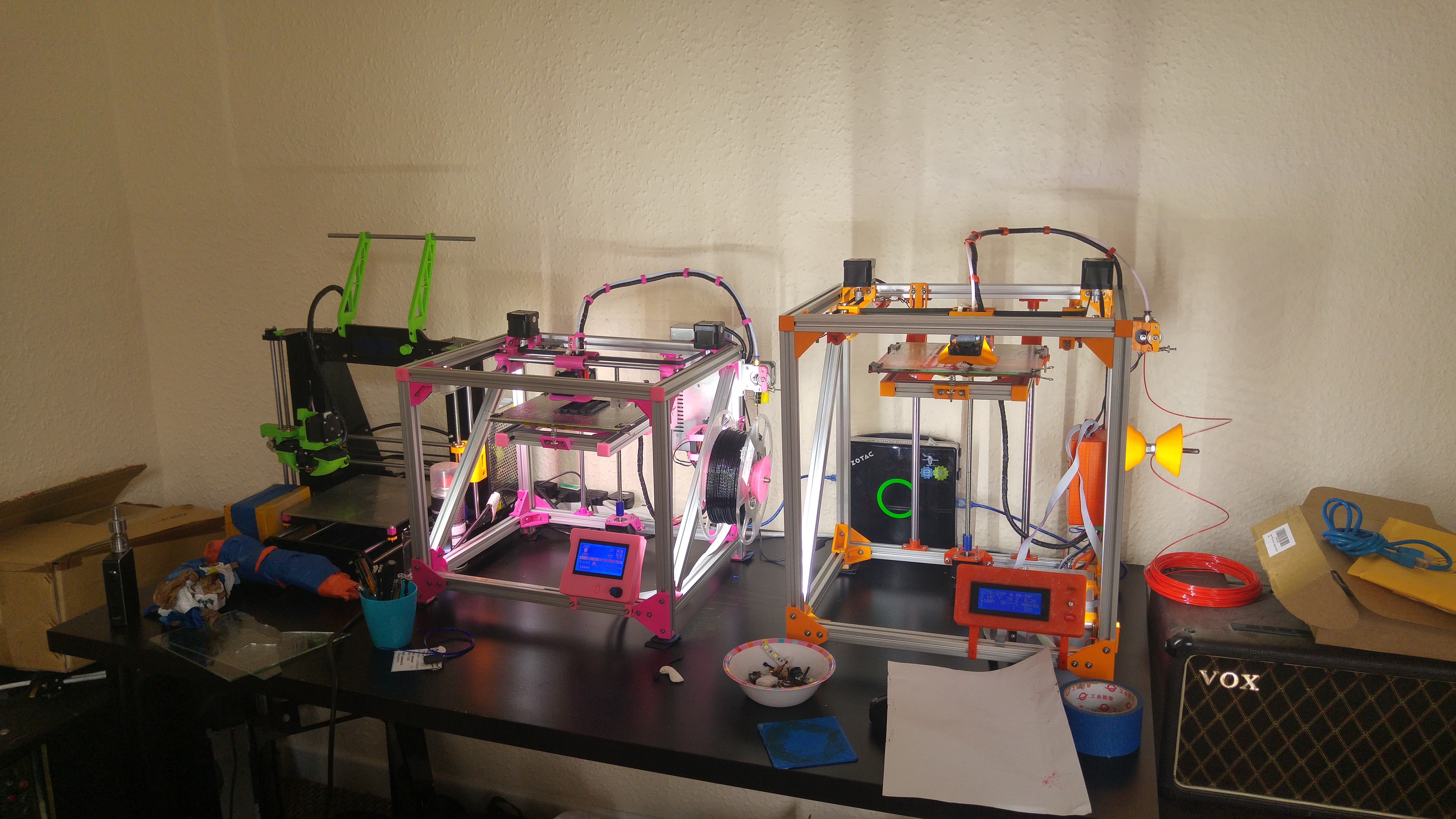

It’s good to be back printing. Have had to move house and gave finally got things back up and running. Have both the #FB2020 and the #FB2020+ at home atm as the #FB2020 needs work with all the new parts to be put in. I’m probably going to strip it right down and rebuild it as the build guide needs finishing. Compared to the plus, it’s damn noisy too. Still, happy to have things back working.

@Jeff_Dewe - The standard FB is noisier as there’s cracked parts and vibrations, and the plus is running printed nylon bushings instead of bearings. Not forgetting that the plus is running pretty much all the upgraded parts, so is a generation or so beyond the standard FB2020.
