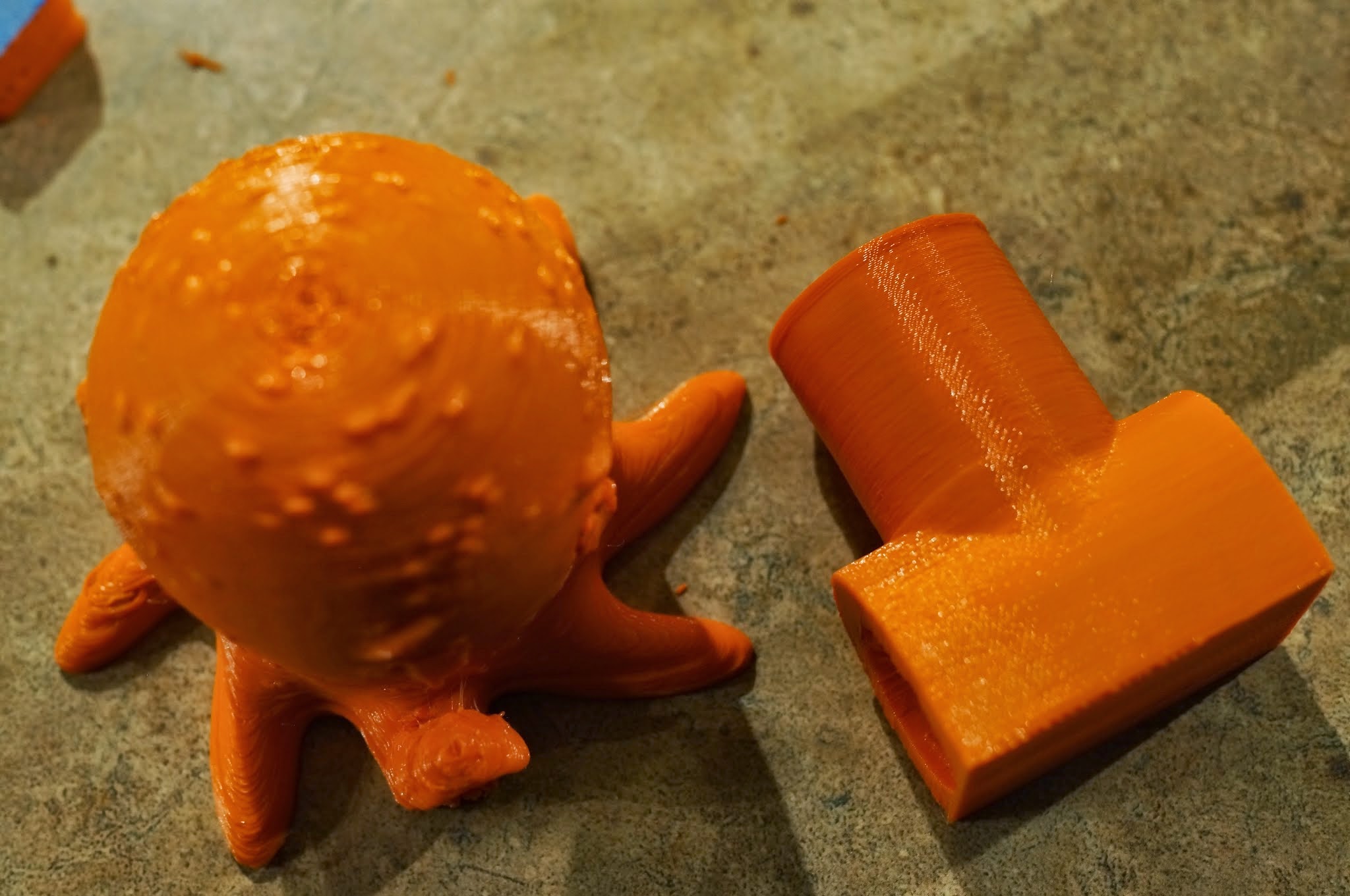

It’s seriously satisfying to see your printer’s quality degrade slowly over time…then solve the problem. Old hobbed bolt on the left, new hobbed bolt on the right.
Wow, that’s good to know cause I would’ve been chasing temp and other extrusion related factors.
So how did the bold degrade? Clogged? Or eroded in some way?
it visually looked okay, but I had to apply more and more tension to keep it from slipping against the filament. the harder I clamped down on it, the more likely it was to deform the filament and cause feeding issues.
At first I just thought the bolt had loaded up and cleaned it out, but it wasn’t til I compared a new hobbed bolt (with nice, sharp ridges) and the old one (which has had a year of use, easy) that it became apparent that the old one was used up.
