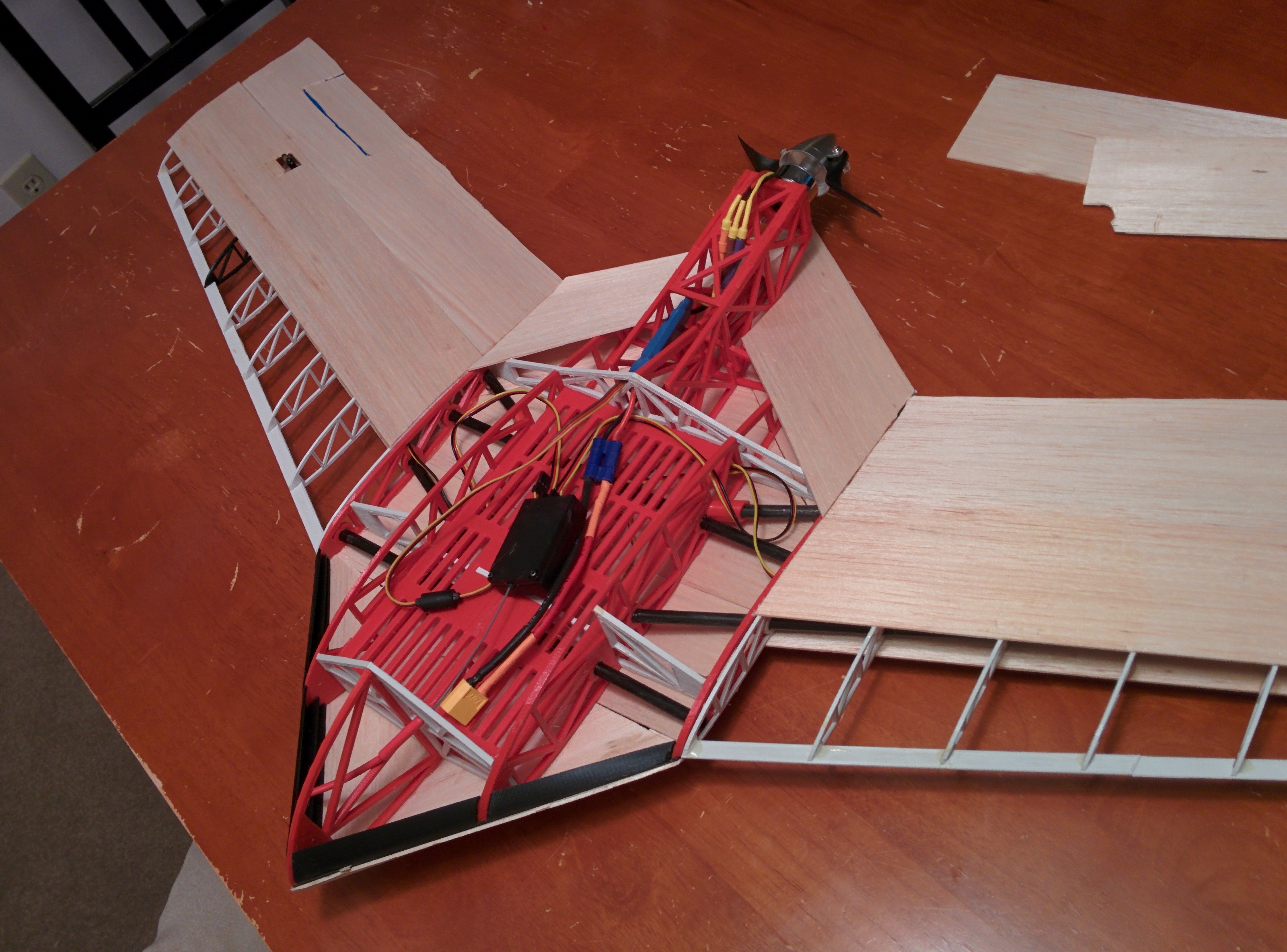

It’s slow going these days but still ticking. I haven’t flown RC in a while either. Just wanted to share my panelling pattern. Check the direction of the grain, especially important at the nose. These are 3"x 1/16" balsa sheets I got for cheap online.
Always nice to see your work. Looking forward to first flight of this version.
I’m getting nervous thinking about it this time around. So invested in success.
Out of curiosity, did you try printing the panels (2 or 3 very thin layers. total 0.25 or something?). I never did, but it occured to me several times…
