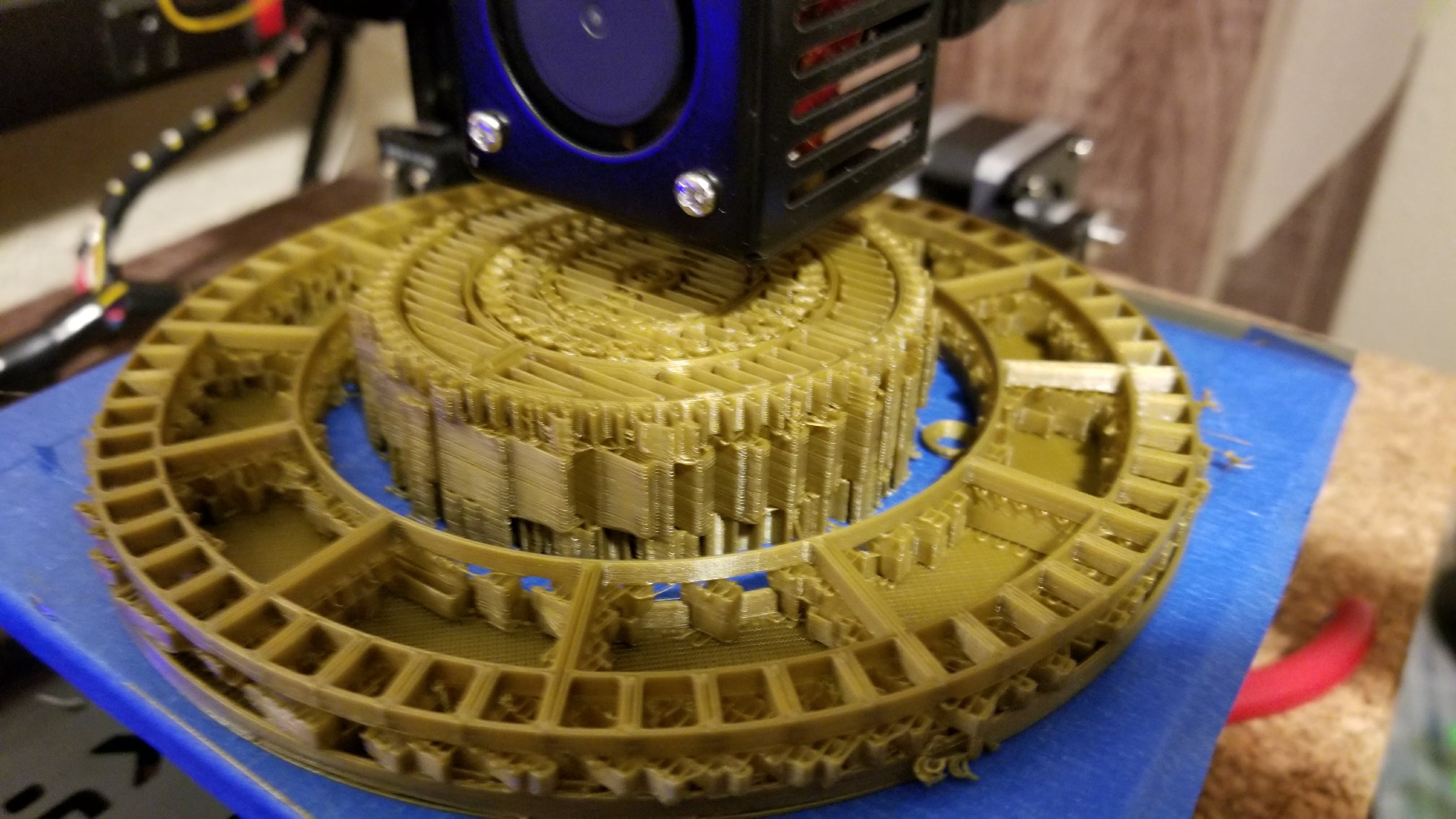

ITS WORKING! Stacking prints is totally working! I'm doing this from now on.
ITS WORKING! Stacking prints is totally working! I’m doing this from now on.
Are you using simplify3d and changing the z location for some parts?
@Robert_Hirsch ​ exactly :sunglasses:
The supports looked like simplify.
