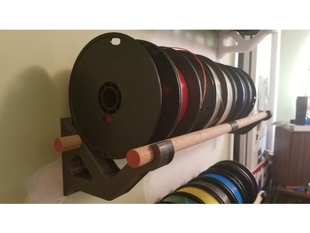

I've been accumulating more and more rolls of filament so I decided to make
I’ve been accumulating more and more rolls of filament so I decided to make a wall mounted shelf to save space and stay organized. I didn’t like the standard design where all spools sit on a rod because you have to take off half to get to the middle spool. My design uses two one-inch wooden dowels to support the filament so you can just grab the spool you need. I even added little tags to go over the dowels to label each group of filament.

Did you print the wall brackets?
@Steven_Archibald yep, that’s what the Thingiverse link is for.
wondering the weight it can hold

Too many spools a good problem to have. Nice design Adam. Been thinking about different racking ways. Looks like I found my new solution.

@Thomas_Chandra I tested it by just piling filament on top each other and got to 20 spools with no issue so it should hold 11 full spools easily which is what 36" wooden dowels will accommodate. The wall brackets are sufficiently over-engineered so the weakest component should actually be the screws that go into the 2x4’s.

I just added a new version which is able to be printed on printers with a more average sized build area. The spools don’t sit as low on the shelf in this version and there is less clearance between the spools and wall (from 1 in clearance to 1/4 in clearance) to make the design more compact.
