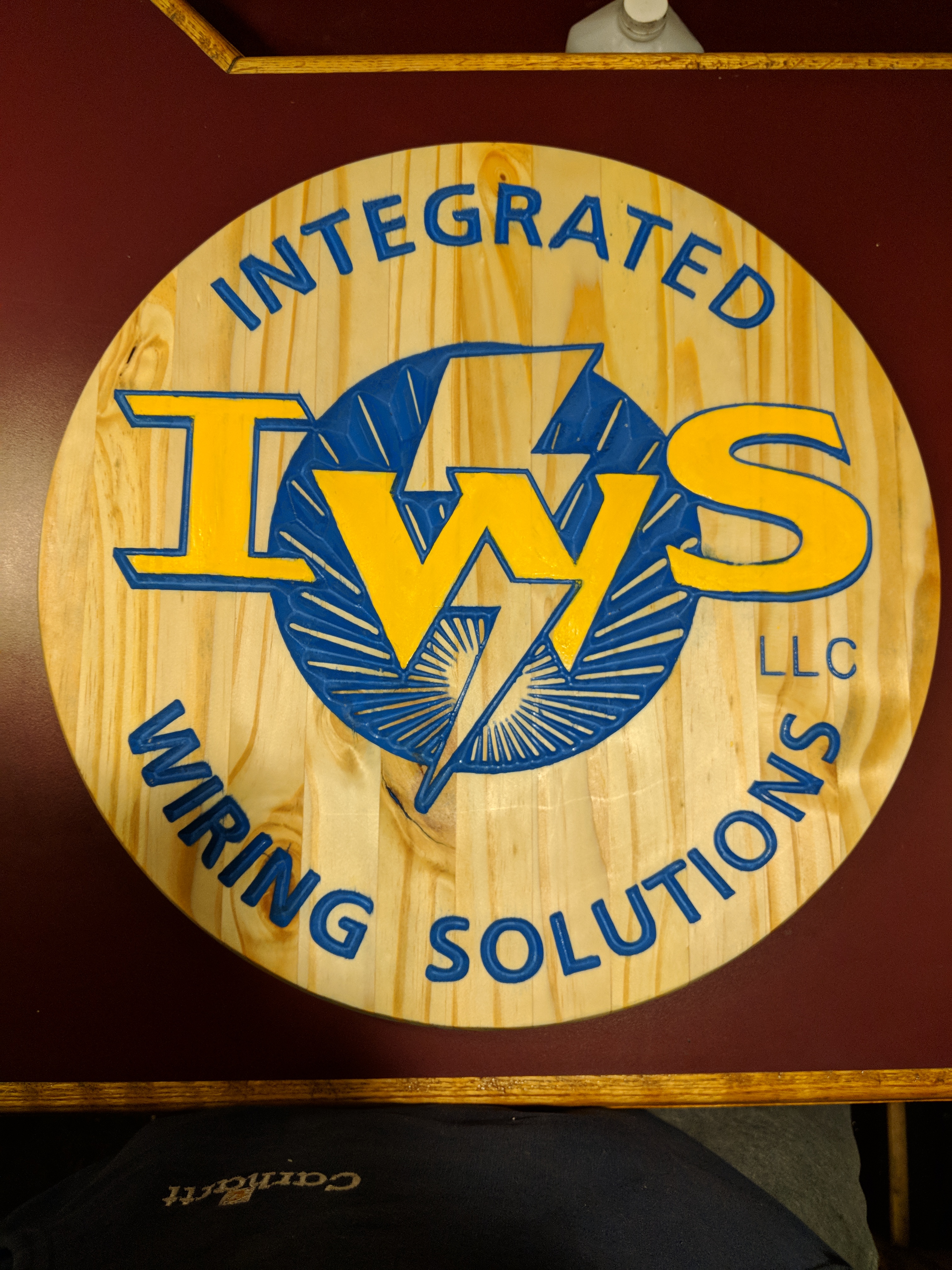

I’ve been busy making 2ft diameter signs on the XXL… loving the V-carve!
Wow those are nice!
What is your painting/filling process?
Do you paint before or after the cut?
@Josh_Rhodes Thanks. I’ve been learning as I go but all of these were painted after the cut.
At first I was just spraying and sanding the whole top layer but that lead to some being over-sanded where the carve wasn’t so deep. As of lately I’ve been masking prior to cutting so I only spray the areas I want and it has less sanding but this still isn’t perfect either… Its a learning process for sure.
