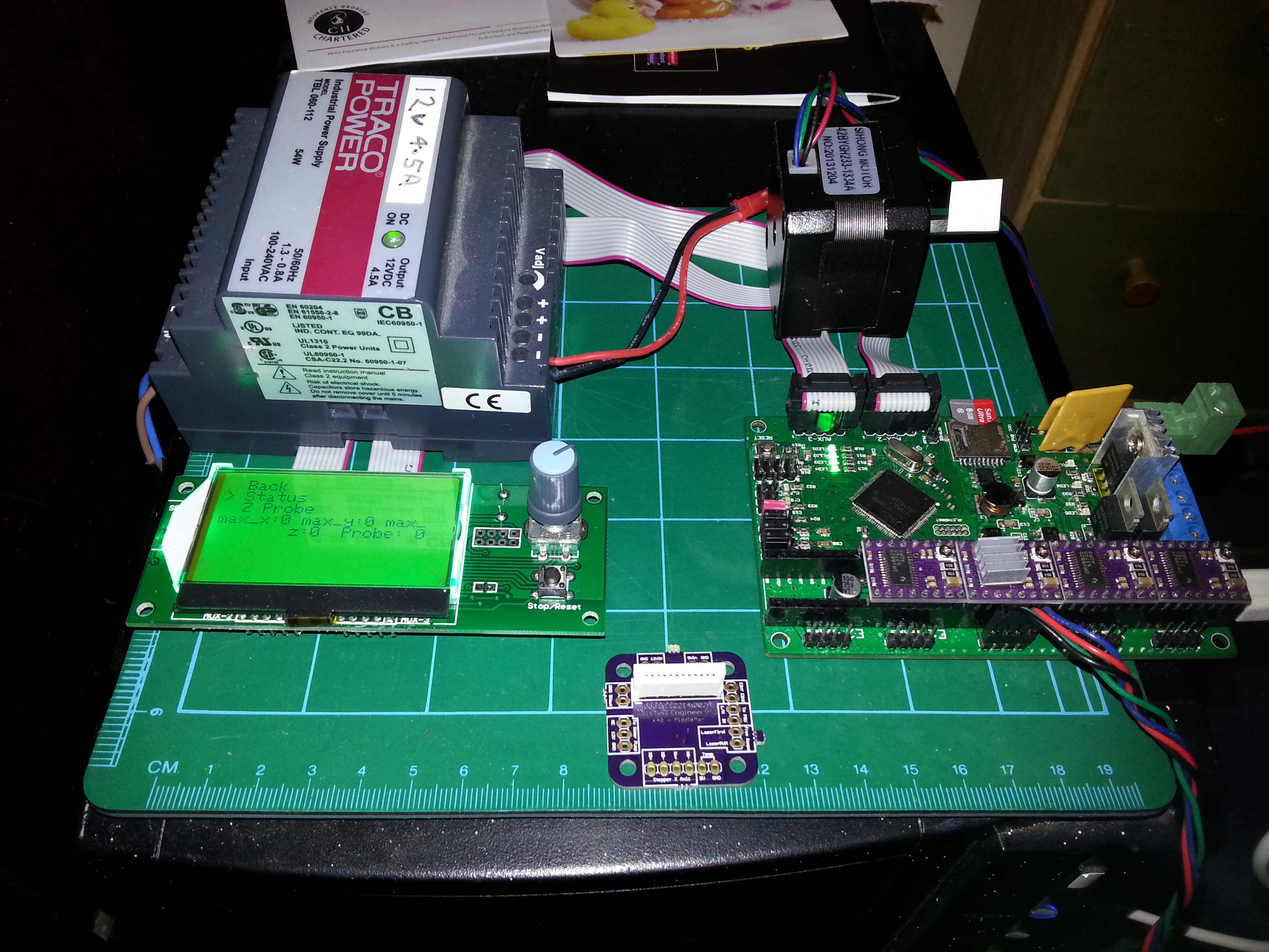

I've been collecting bits and pieces together to make a new motion controller,
I’ve been collecting bits and pieces together to make a new motion controller, the first thing I shall try it on will be my K40 laser engraver. I think it will end up on my delta 3d printer eventually though. At the front of the photo is the little middleman board needed to breakout the laser ribbon cable to something easy to wire to. The main board and LCD are the AZSMZ Mini controller and display, it runs the smoothieware. it all just worked out of the box even without an SD card inserted, the software defaults match the hardware. I’m tuning the configuration with my own setting right now however. Next job is to set the stepper current as its running into overload when working for more than a short while.

Ive beeen busy elsewhere so sadly very little progress to /date. I have the esp8266 wifi serial link working nicely. I made a display case using a 3D printer design I found on thingiverse. All the board configuration looks good to go. I need to take the plunge and swap out the existing controller next. D
