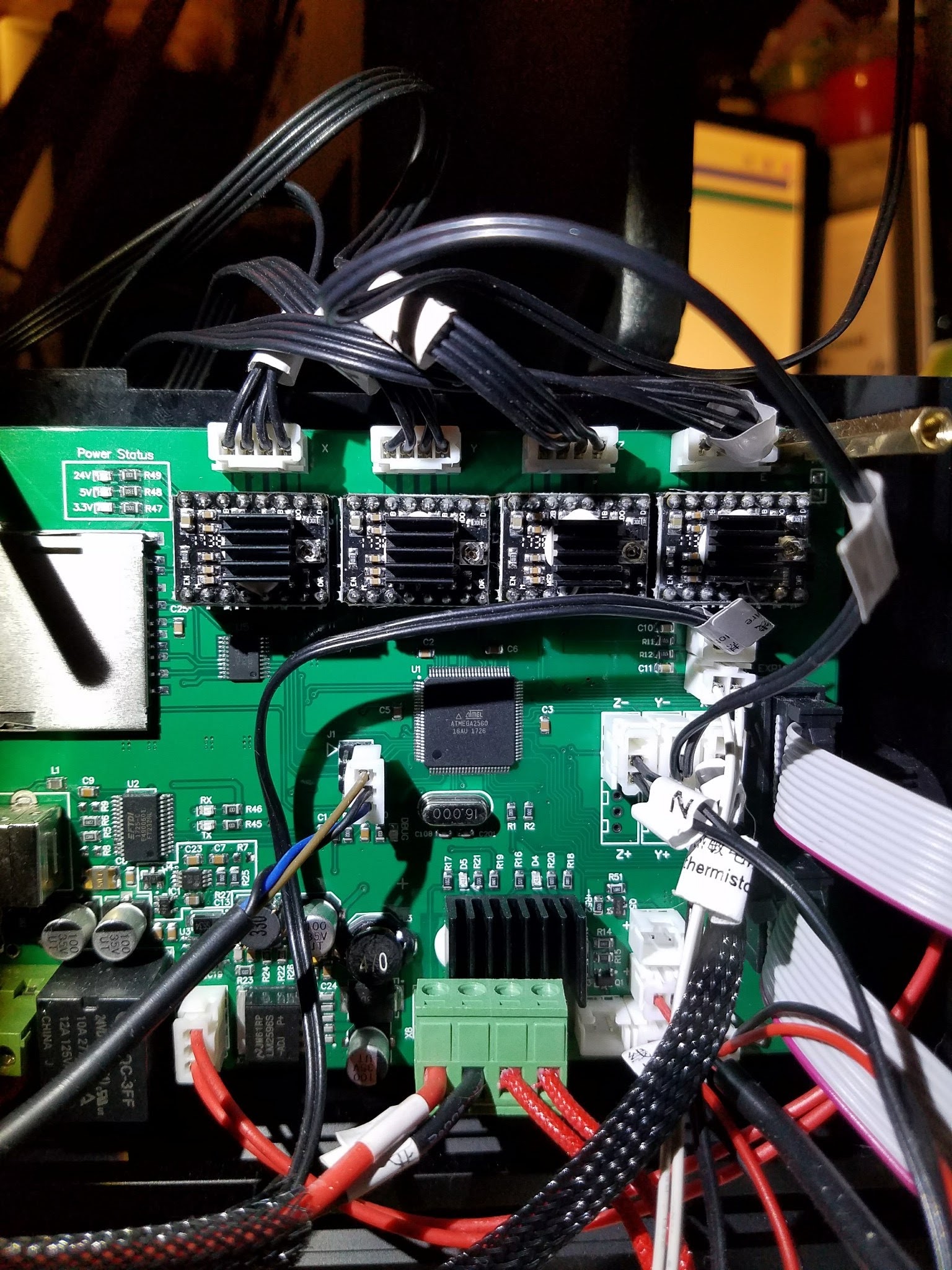

@DayRider76 what’s the Mainboard the printers use ?

@Daniel_Stauffer I don’t know, not labeled?

@DayRider76 can you post a pic?
Yea, I’ll open it up after work

That’s an atmega2560 with ramps comboboard I think. the drivers should come installed together with the Arduino ide which is used to flash the firmware on this type of board. Have you installed the Arduino ide?

@Daniel_Stauffer I just sent the driver recommendation to my main pc. Time to work on the ender. The flsun kossel? I did the marlin set up as recommended by flsun. Went step by step, must be a translation gap, the printer just ripped the rods out with the home command. I know it’s a stepper reversal issue, but now the board won’t accept commands from marlin and the screen is blank? This is what I get? Two printers at once
Did you try to flash a new firmware? It would be very helpful if you could describe step by step what you did.
