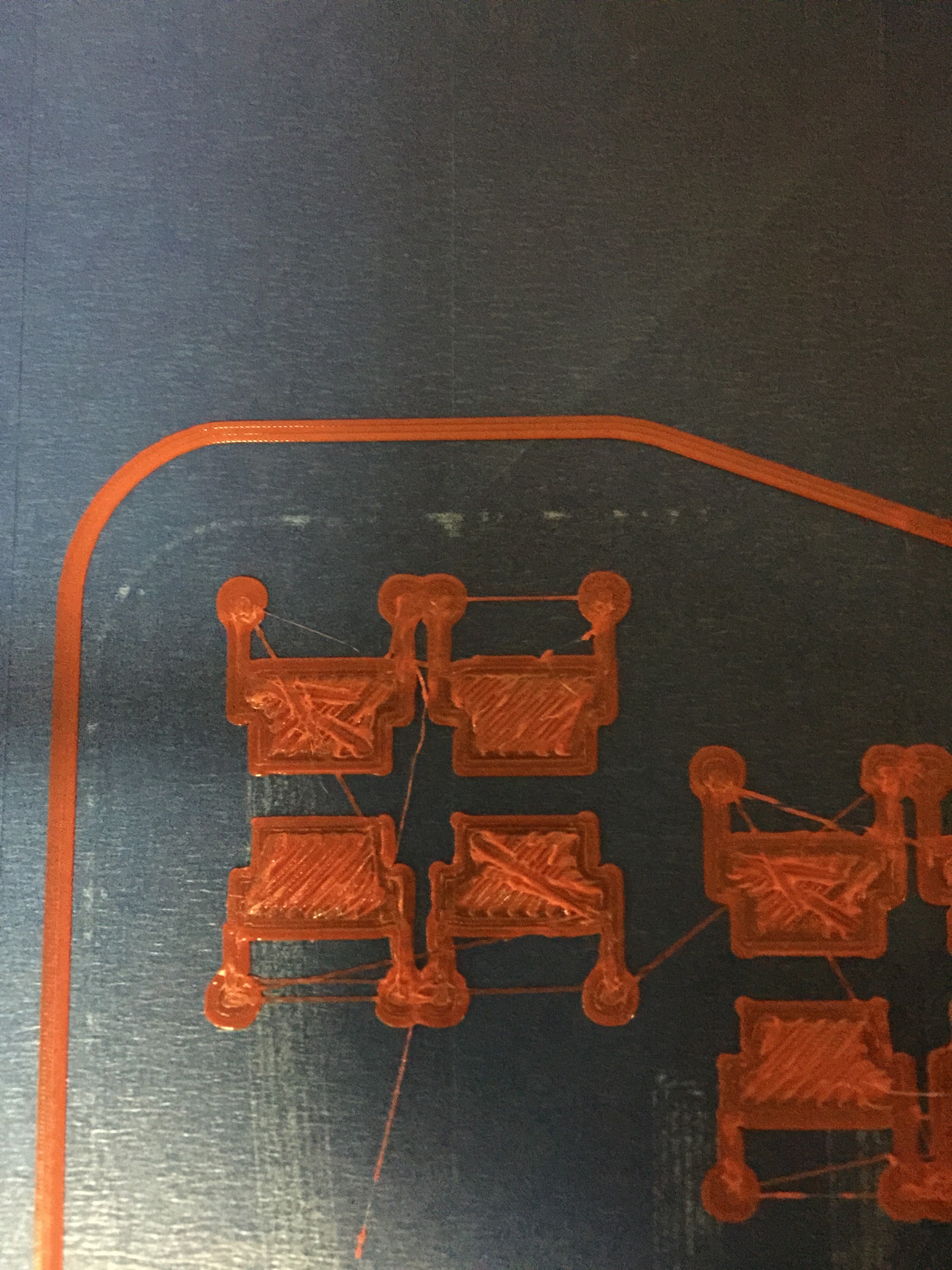

I’ve been getting some excess filament when printing. About 5 hours into printing the gauntlet it got caught up and shifted the entire print over 1/4 inch.
There were some strings (technical name?) hanging between the sides of the gauntlet that I think probably need addressing.
The cable chain seems to be starting off a little rough in the picture.
that looks like over extruding, or close to the bed, but id bet on esteps too high, try turning down by 10% just to see what difference you get, or raise z height a nats knob. You might even need to do both

I wouldn’t touch esteps if it’s already been okay before and i guess you already did a calibration on esteps?
Then like Eric said calibration per filament role would be important. If you use an extruder like Slic3r their are quite some options to setup your profiles right for extrusion - with S3D i didn’t have too much luck with that so far but that’s maybe just on me
It’s the same for every printer. My Prusa E3D started to print a lot better once the esteps were set correct (i.e. 1 cm of fillament is really 1 cm), and I started to check the fillament diameter (3.1 mm is not equal to 3.0mm). Further make sure nozzle parameters are set correctly in in slicer software, e.g. slicr3r. Then you get into the next step of setting retraction right.
I bet if you printed the same object again youll get slightly different ± 0.05 without changing anything with ref to X and Y. Loss of height on the Z will be in part to do with Z height setting and the squish onto the bed
