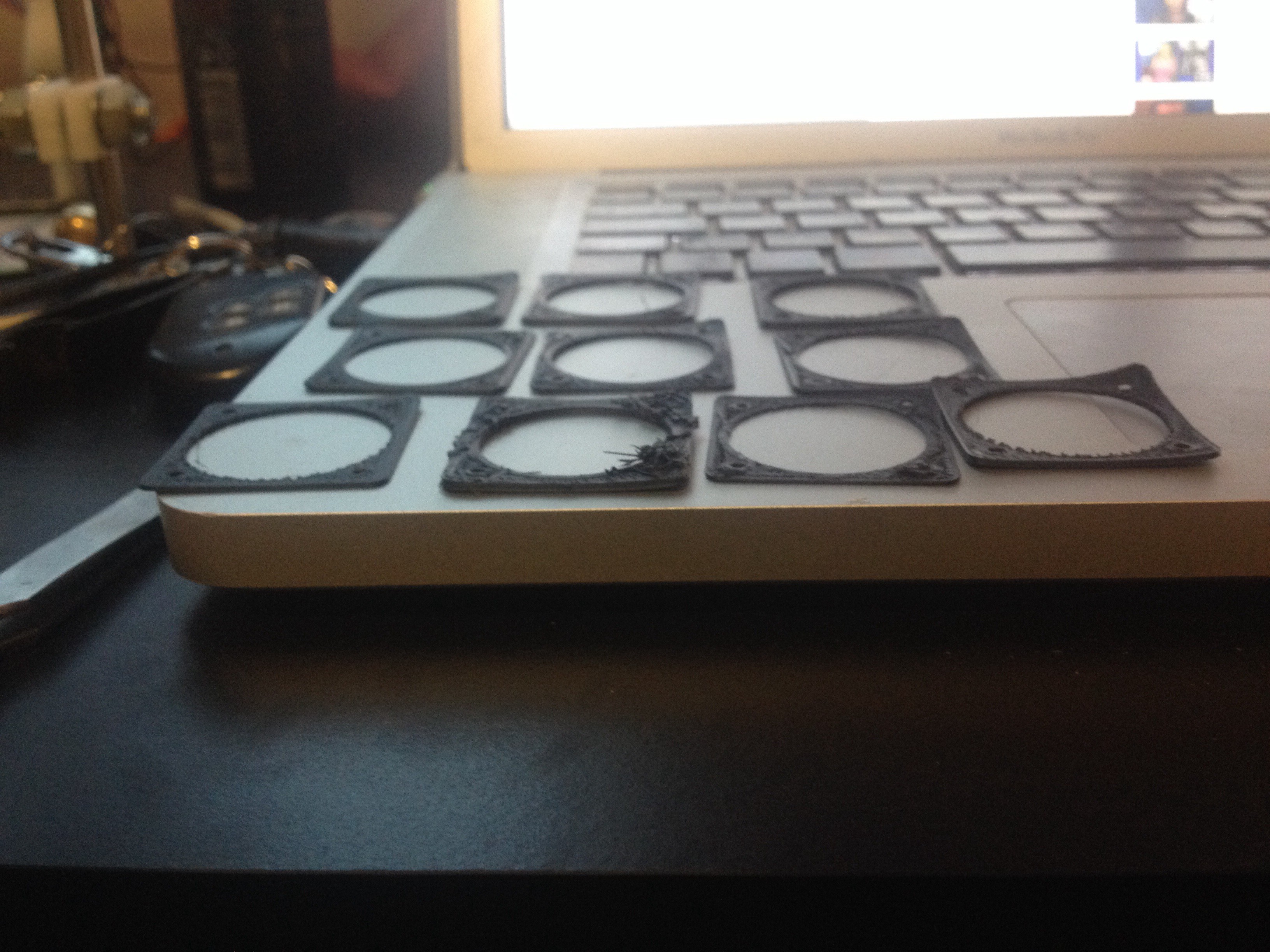

I’ve been getting some warping issues with ABS recently. All seems to start on the top right corner. Tried various solutions. Kapton tape being the latest but still not able to stop my prints from coming away from the heated bed o_O

@Richard_Mitchell and @Bastian_Schneck I’ve tried hairspray in the past but that was before swapping out the glass and using kapton tape before. The print seems to stick better in general apart from the back right section which lifts after a few layers. The most recent print seems better, still warping in the same place, it seems reducing the infill helped keep the part in place.
Put helper discs in the corners or turn on brim if your slicer has it. ABS wants to shrink. And the shrink forces concentrate at corners. Once you have a small peel, it will keep growing.
I think @Richard_Mitchell may be on to something with the ambient temperature suggestion. I’ve turned the heating up in my room and the latest print seems to be sticking.
