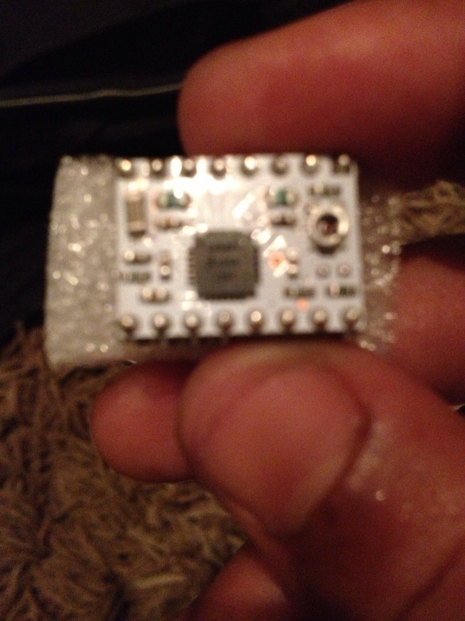

I've been having problems getting a the a988 stepper driver working for my megatronics

When I turn the board on the USB power led stays on for a few seconds and then it fades and won’t come back on again until I remove the driver.
It seems as though the ATX PSU can’t give it enough power but I won’t know until I get time to try another PSU.
I see the problem… it’s out of focus :slight_smile:
If you’re not driving a motor, it shouldn’t me drawing current. @Whosa_whatsis is probably onto the problem, make sure you’re not shorting one of your power rails out

The issue actually seems to be with the power supplied via the USB connection. The PSU supplies power ok and isn’t shorting.
I don’t have the same problem when I put my old stepper driver back in :expressionless:
Sounds like a short on the driver board’s 5V line. Unless you can see a bit of extra solder or an error in the copper etching, it’s probably a damaged or defective chip, and the only thing to do is replace it.
@Whosa_whatsis cheers for the advice I’ll get a replacement and see if that solves it :slight_smile:
