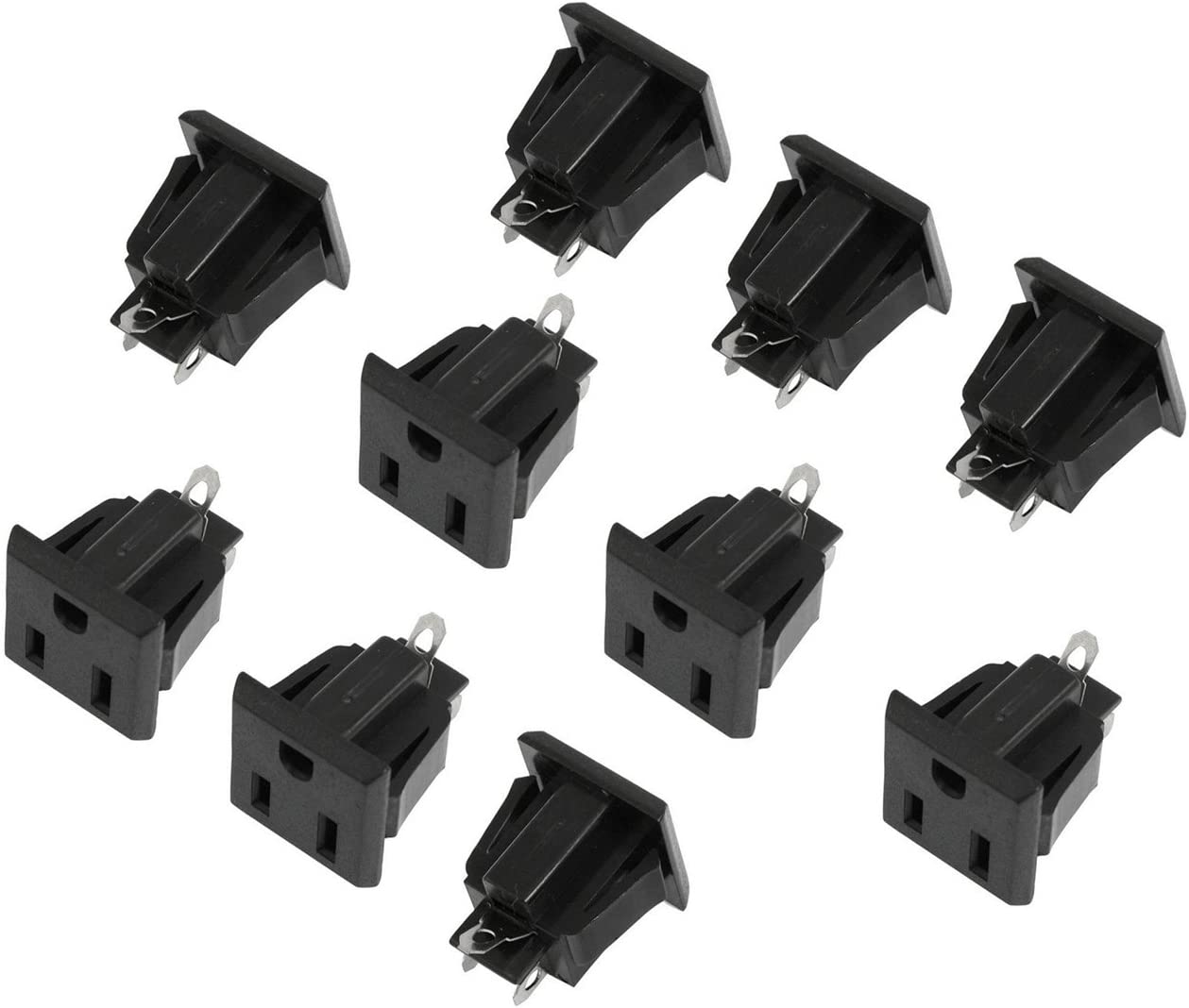

2: The back of the machine looks like it has 2 switched outlets. I’m guessing that when I power the machine on, these also get power. Both of these 2-prong plugs. Would it make sense to convert these to 3-prong plugs and tie the 3rd to the ground so everything is common? Possibly a stupid question - I really have no idea.

If you are going to plug devices with 3 prong plugs into the outlets convert them to 3 prong and wire them correctly using this to verify they are. Good Idea anyway :).

Thanks for the info! Got a plug tester thing down at Home Depot, similar to the one you linked, and I do indeed have Kosher 3-pronged plugs.
For the switched plugs, I was mostly thinking about the water pump - just always having that on if the machine is on. I think air assist and exhaust will probably be on more than the tube but it seems like serious overkill to have them on always…
