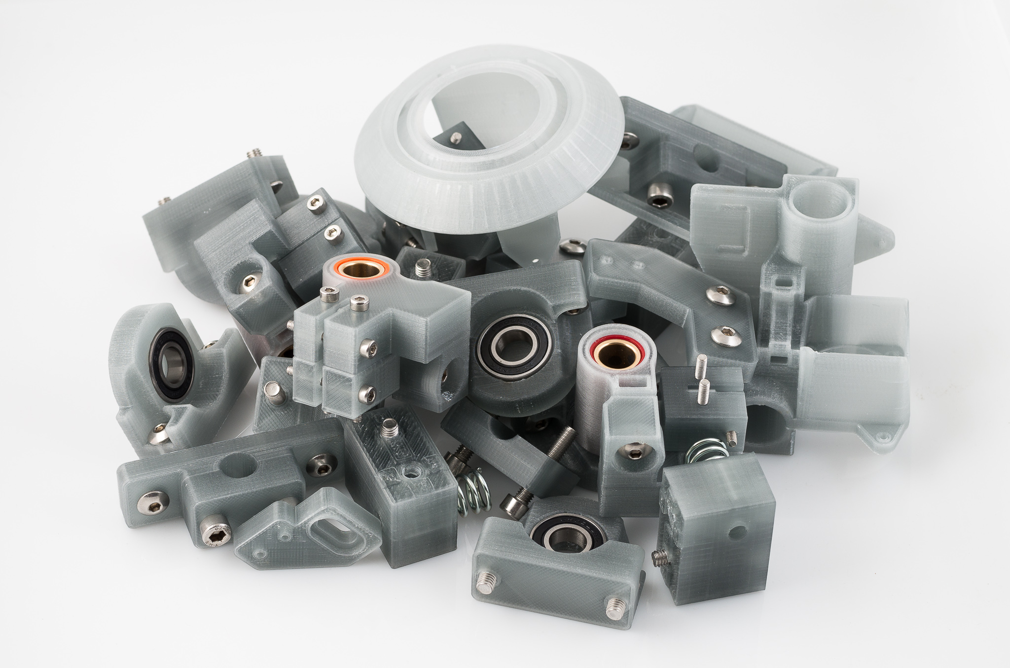

I’ve been taking pictures of most of the Eustathios parts as they’ve been coming in, I figure someone might be useful for some future documentation. It’s not quite a stock v2 Spyder build, I switched out some parts because I’m cheap (and will probably end up regretting it), but it should be similar.

What was used to print that?
I like the look of that plastic. Where’s it from?
It was printed on a RigidBot (one of the kickstarter printers). The plastic is Hatchbox Transparent Black ABS from Amazon (the PLA is similar, but has a slight yellow cast to it and is very slightly less transparent). I think it only comes on 1lb spools. Part of the look comes from being printed at 100% infill.

@Walter_Hsiao Good looking prints. How is the rigidity on the transparent abs compared to an opaque? I almost ordered a spool yesterday. I understand in order to have transparency, quite a bit of Butadiene is removed (or not added) to the resin.

@Isaac_Arciaga I haven’t really noticed a difference in flexibility, but I generally find transparent ABS to be much more brittle than the opaque versions, and it tends to crack under load. So maybe not the best choice for printer parts, hopefully it will hold up.

In terms of strength, I would be more worried about the fact that you appear to be printing completely hollow.
Further up the thread it says they’re 100% infill…
@Chris_Brent I was wondering about that. That’s pretty great clarity for 100% fill.
Ah, my bad. Interesting how 0% fill and 100% fill look so similar. At 100%, I bet you went through at least one entire 1lb spool of that stuff.
Ha, definitely more than one, The picture doesn’t include the larger z-axis pieces, I think some of those were a quarter pound each. That filament is lightly tinted, it’s very similar to clear ABS when it’s hollow.
