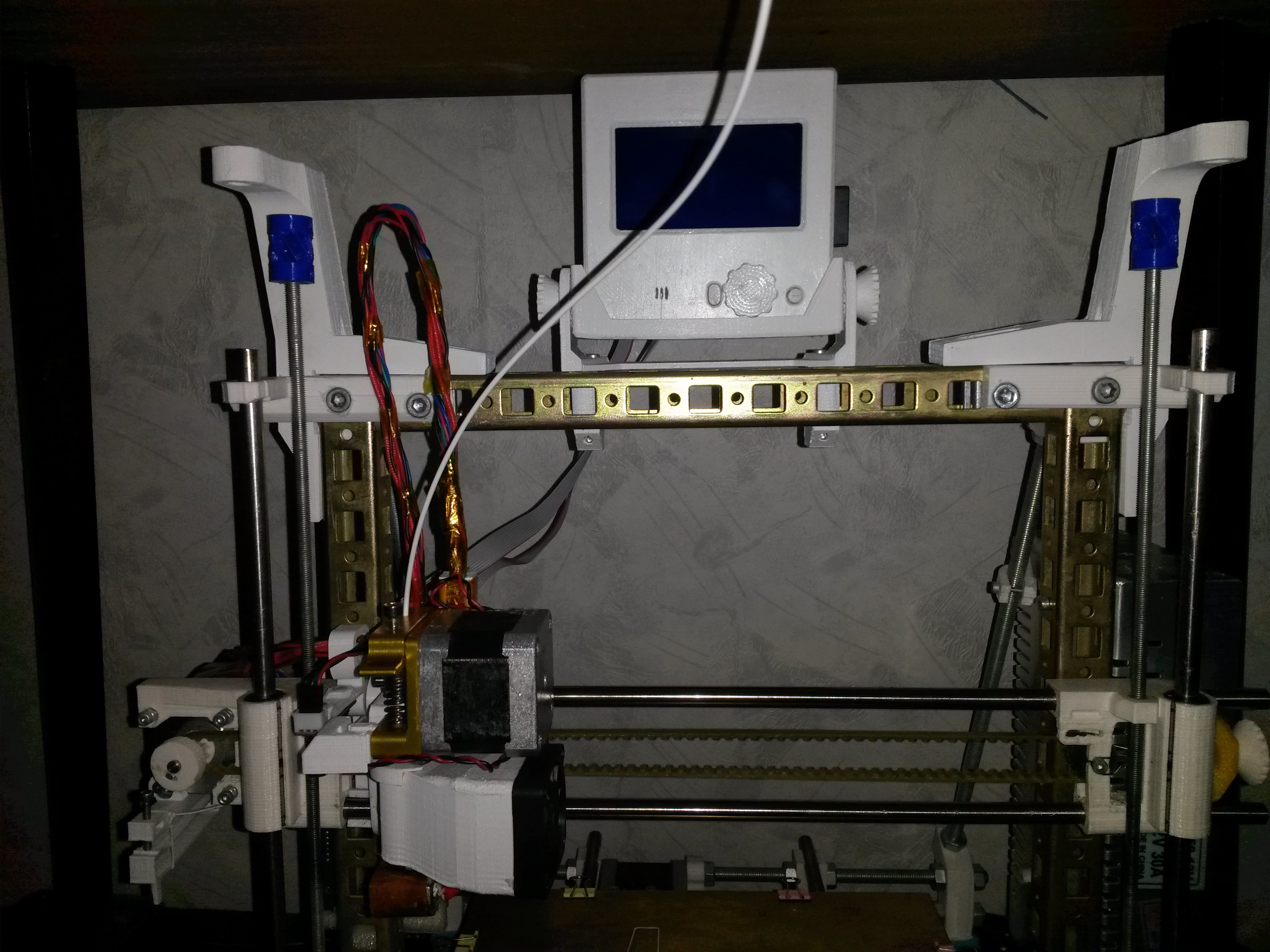

I've been thinking for a while now to make the entire frame volume usable
I’ve been thinking for a while now to make the entire frame volume usable and so, while I’m waiting for the new 370mm smooth rods, I’ve printed these “frame extensions”. They’ll help move from only 165mm on the Z-axis to a “whopping” 240mm. (215x215x240 - not bad)
And it makes the printer look cooler (I think).
