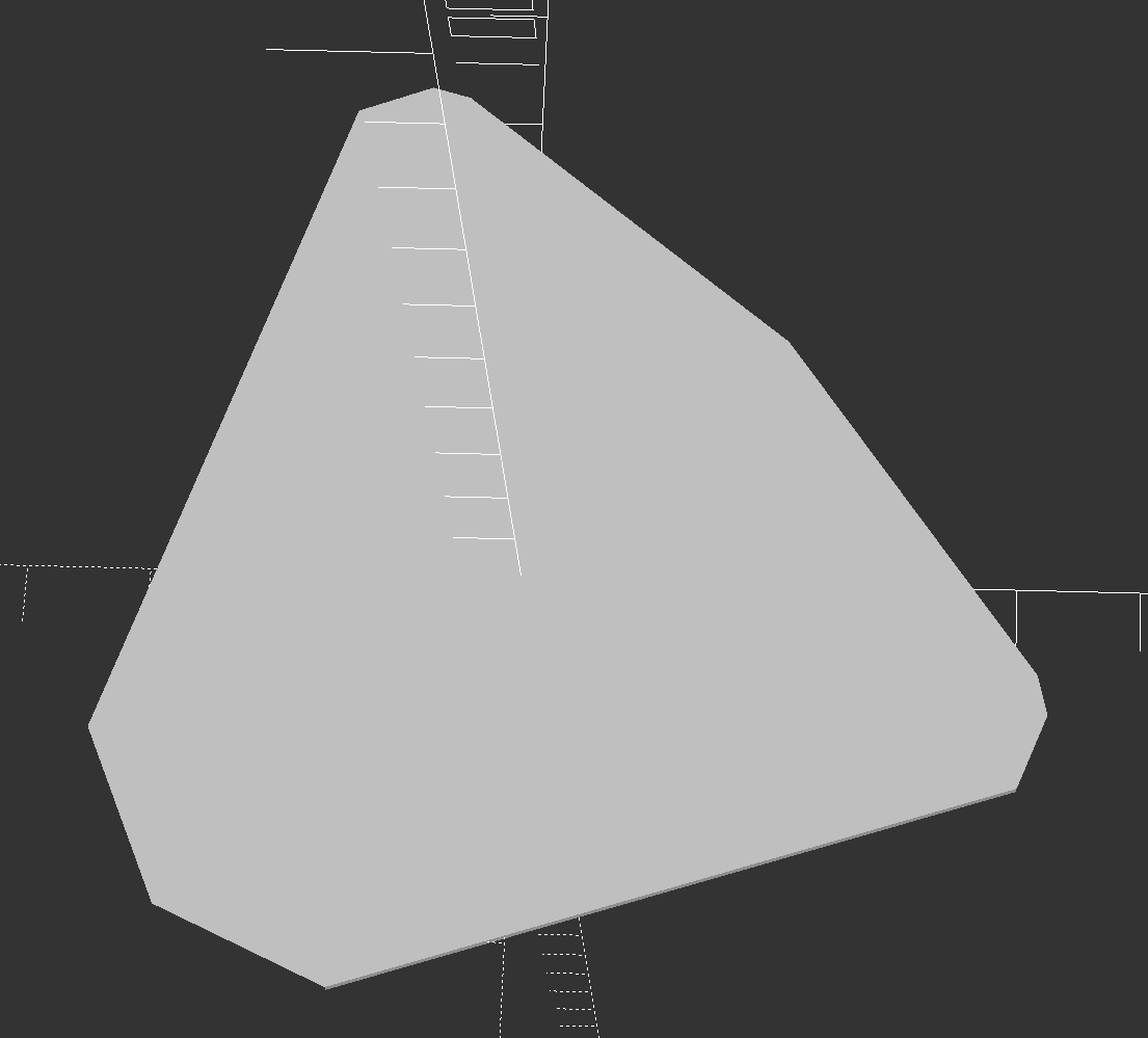

Thanks @Carlos_GS but that results in the same thing. http://imgur.com/WMClbq0
Maybe my dxf should just have more vertices?
FWIW I did have some success importing the dxf in inkscape and then exporting with bigbluesaw dxf plugin, but the scale was totaly wrong (my dxf is roughly 70mm square. the bigbluesaw dxf was about 2mm) not sure why.
