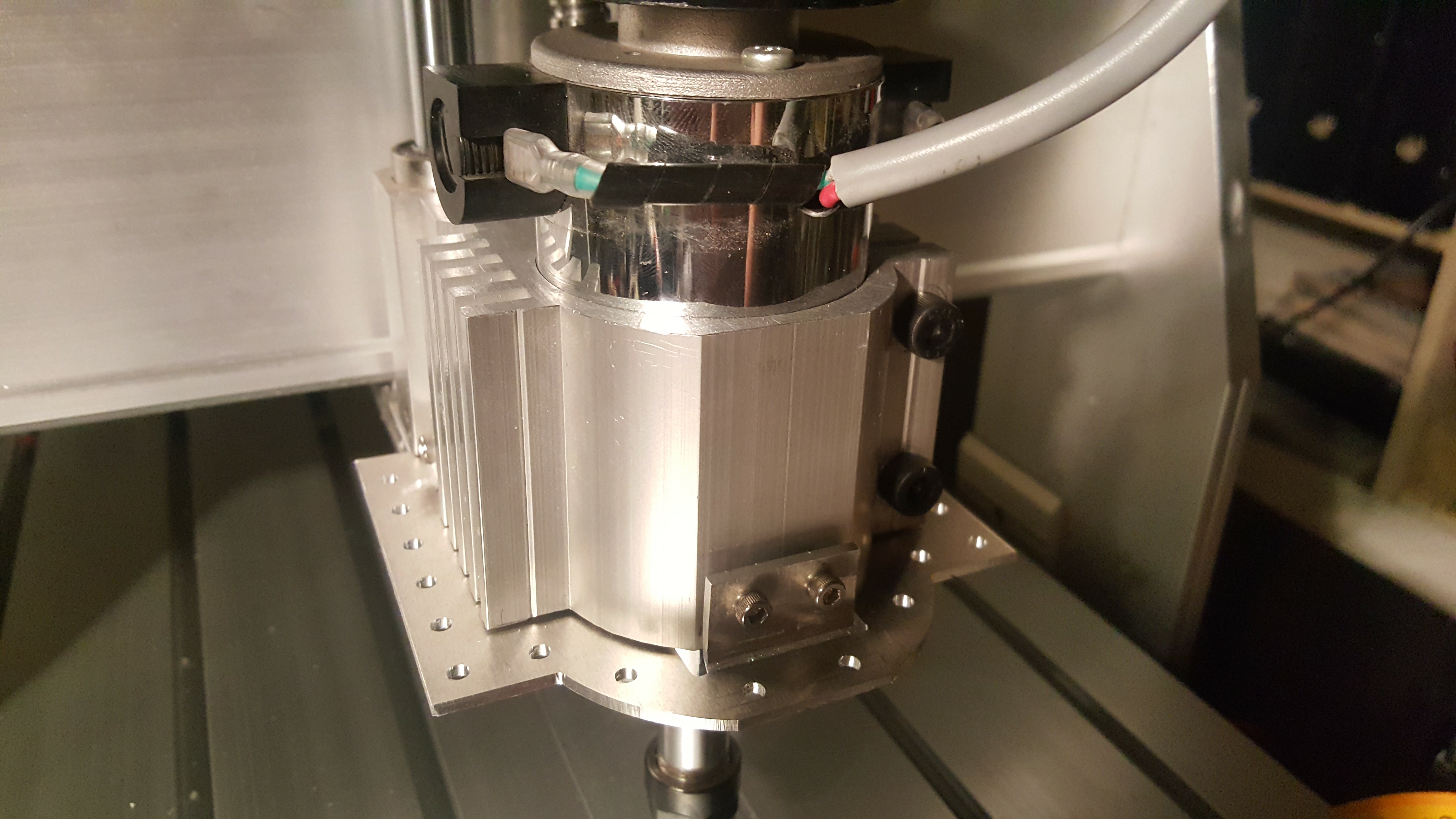

I’ve been wanting a way to attach add-ons to my 3040 CNC forever. I finally broke down and made a perfect aluminum bracket so I can swap in/out custom acrylic holders for lasers, solder paste dispensers, @Frank_Herrmann 's XATC, etc. I love how it came out. Only broke 2 end mills getting this aluminum milled.
Awesome, i like this design. I’m curious what u want to add on this beautiful holder?
Only broke 2 endmills hahaha. Awesome John.
Well, I have all sorts of PnP stuff I still need to dive into including Ray’s custom adapter. I always have 2 lasers going–the 0.1mm precise UV and the powerful 450nm NUBM44. And I still have the DMP16 auger. I’ll end up with still swapping but this will make it easier.
Nice! So, anything you want to share about milling aluminum? Not that it would apply to my weakling 300W spindle…
@Kevin_Hauser I do aluminum on my 300W spindle. No problems.
Ok, here’s what I found for milling this plate. I used a 2.4mm two flute HSS end mill. Ran it at 10k RPM on my 300w spindle. Did a 0.2mm depth of cut at 120mm/min feed rate since I was milling slots rather than edge milling. I probably could have gone with 0.5mm but kept it safe after breaking my single flute 2.4mm end mill. I ended up with aluminum chips that I think are too small but slot milling is scary so better off going slower. I used @Brandon_Satterfield 's recommendation of the Tap Magic Aluminum spray as lubricant which did wonders.
