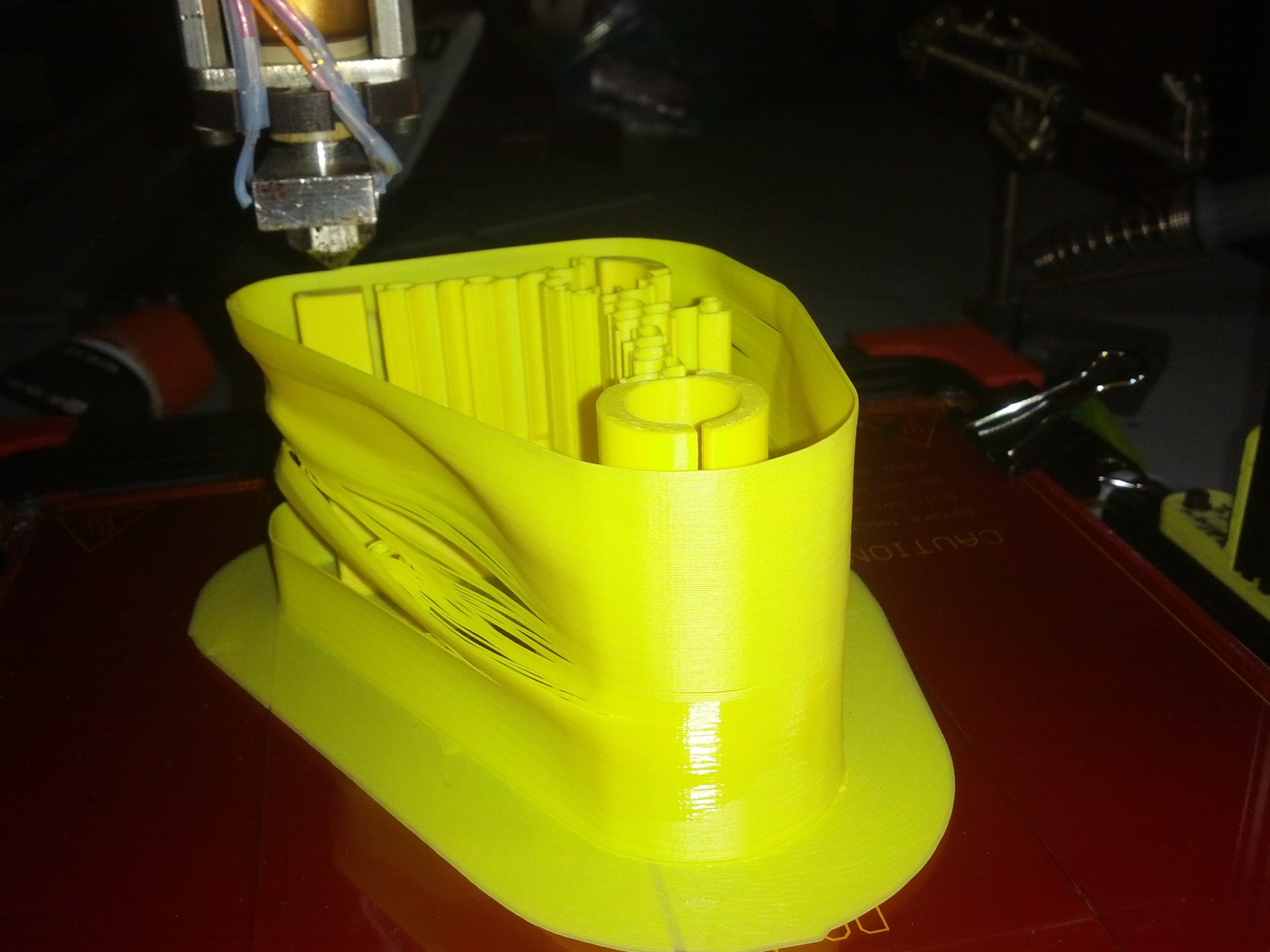

The prints have been working out great so far! The yellow pic is how my thin walls often in ABS tend to go (although this is an extreme example and while I was testing the effects of skirts on prints) the red and the green are in PLA.

What sort of problems were/are you having and what sort of results are you getting from the higher temps. The yellow seen above (MBI ABS yellow) was at 225C The print itself turned out fine, but the thin wall of the skirt obviously had problems.
Edit: Although it’s not entirely unexpected to see that result with the skirt. The inside temps are warm and the outside are cooler which would cause the outside to contract faster and result in those inward curves.
Generally, splitting and delamination. You might double check filament dia by measuring the filament you’re printing. The yellow PLA looks like you may have been under extruding. Or just going way too fast.
I measure my filament religiously on X and Y cross sections. The yellow ABS extrusion speed for the skirt was about 25mm/sec.
