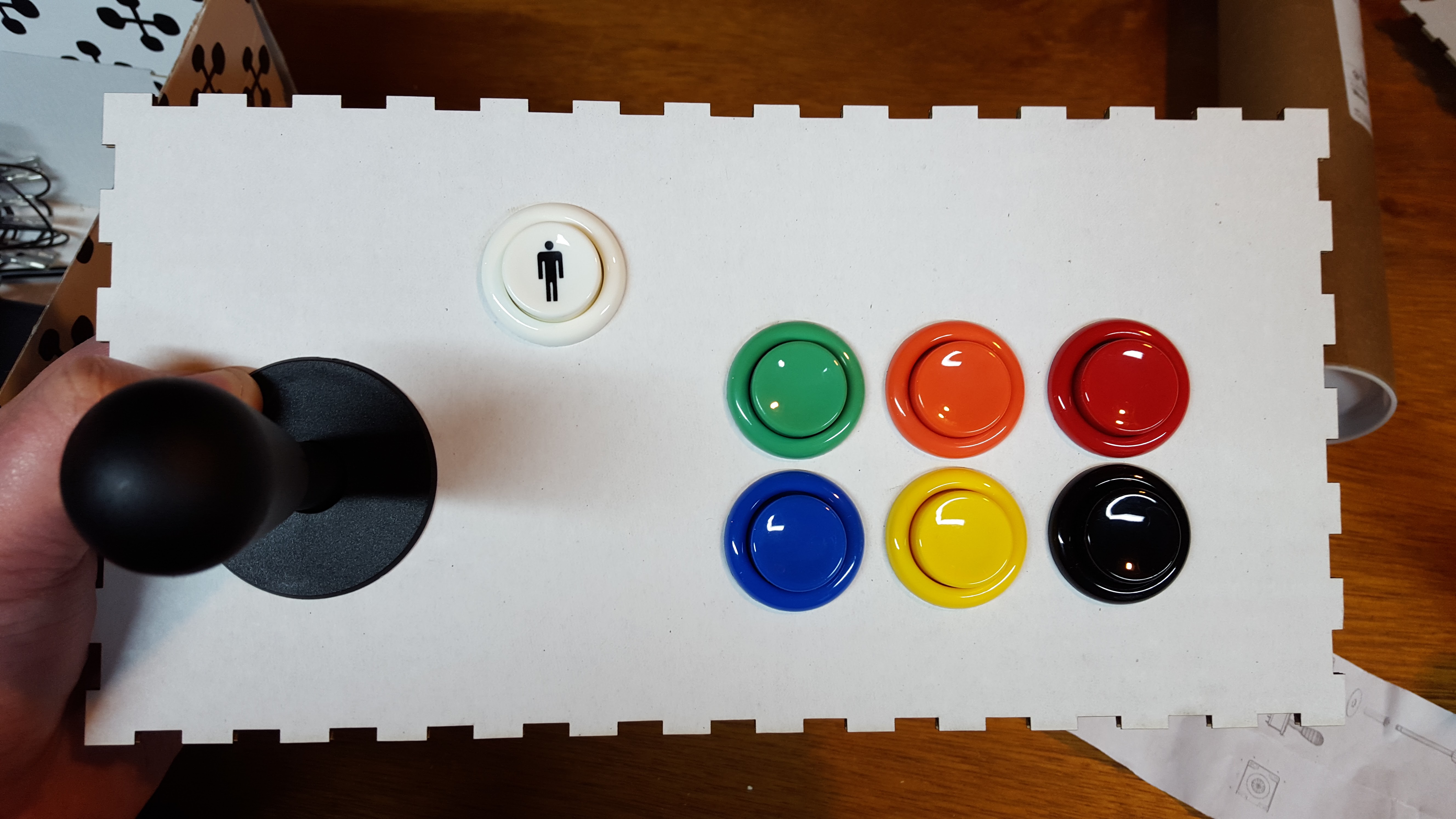

I've been working on an arcade controller layout, it's almost there.
I’ve been working on an arcade controller layout, it’s almost there. The player one button is still to close to the stick. I also need to create some slots on top for reinforcements up from the bottom.
very clean job !
That looks great :slight_smile:
Nice! How does it interface?
@Sean_Cherven I plan on using a Xin Mo board which breaks out pins for 10 buttons, and a joystick for two players. Windows just shows it as a generic two player joystick which is fantastic for mapping to games.
@thanh_tran ​ The picture is just cardboard but the final design will be 1/4 inch plywood
