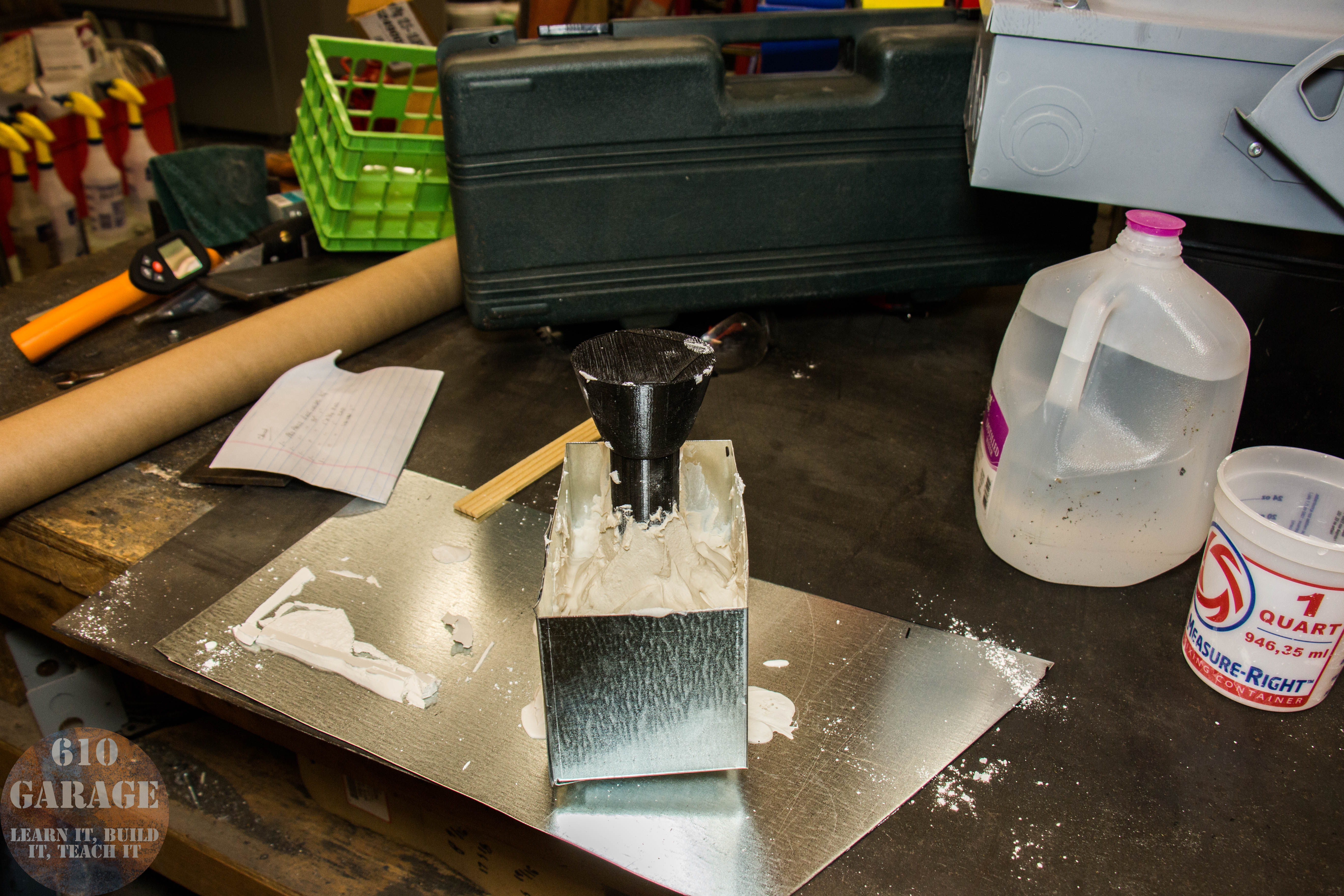

I unfortunately don’t have a pic of the print. It was just a failed print of a ram cooler I designed. Anyways, I submerged the print into plaster of paris. Let it cure for a few days, then placed the print and plaster into my kiln and heated it to 700F-800F. This melted out the 3d print and left a void in the plaster of paris mold. I should have gotten to 1,000F, but I had to cut it short.

I did have some cracking in the mold. I’m not sure if that is because I had to let it cool down, or I heated it too fast. So there is still some testing that needs to be done. Next I have a model of the Prometheus from Stargate SG1 off of thingiverse. I’m printing it now, so we’ll see how we’ll that works. :slight_smile:

Try to add a vent away from where the aluminum is poured in. Also look at wall thickness. Remember metal doesn’t like thick then thin then back to thick.

@Alan_Wiggs Yup. I figgered this was small enough that a vent wasn’t necessary. It was also a test. So I was testing the limits. :slight_smile:

I’ve used a 50/50 mix of sand and plaster of paris, cured for a couple of hours, burned it out on the charcoal grill, and poured right into the hot mold - no cracking. I don’t know if it is the extreme preheat or the sand…

Did this same thing in my furnace, but didn’t pay attention to the temp: I literally melted the plaster into a glowing glob on the bottom. It does not smell good when melted :S Live and learn eh? :wink:

@Alan_Thomason @Eric_Pavey Thanks. I have a feeling that it is best not to get the plaster of paris past 500F-600F. I believe at around that temp (hard to remember, I should write this stuff down :slight_smile: ) the pla started to burn off/vaporize. I also didn’t see any more cracking as I poured the aluminum in. So thermal shock may not be as big of an issue as I originally thought. On the next one, I’ll only perform burnout up to 600F to see if it cracks. And I’ll make sure to document temps a little better. One of the great things with the kiln. Fine temperature control. LOL :slight_smile:

@610GARAGE I had absolutely no temperature control on the charcoal - plaster/sand mold was glowing a very dull red; but, I have no idea of actual temerature. I would like to hear of your results.
@Alan_Thomason Hmmm, that’s much hotter than 600F. LOL :slight_smile: Maybe the sand does help. I’ll try both and I’ll definitely report back with the results.

After my ‘incident’ I read that plaster melts around 900deg : My furnace can hit 1900ish I’m told,… thus the melted goo :S
