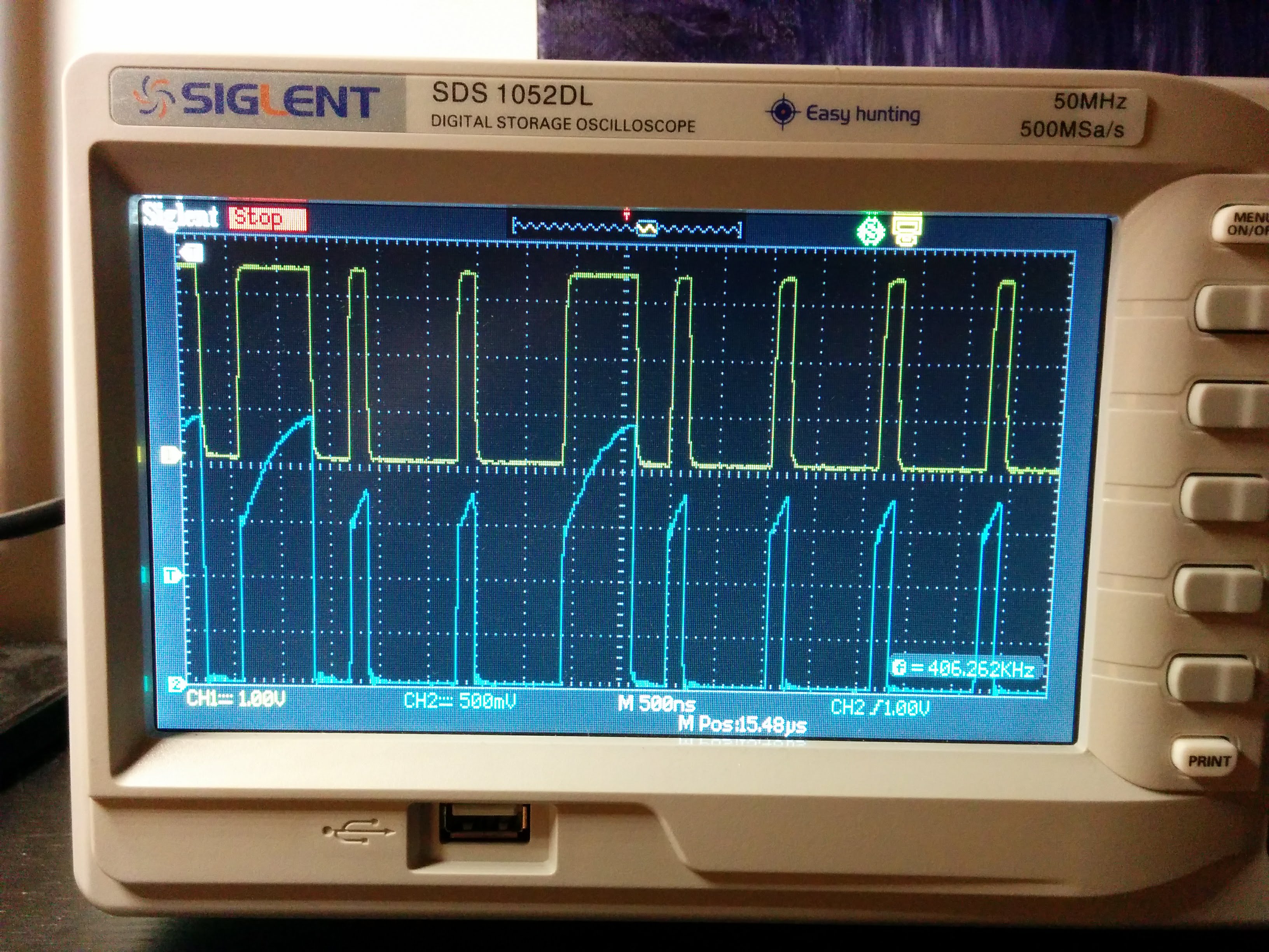

I’ve been working with a 3.3v device, STM32 blue pill, and used a logic level converter (CYT1070 I think) to bring the signaling output up to 5 volts. I kept dealing with weird flickering so set up an oscilloscope to check the output. Top signal in yellow in the image is straight off the STM32. Bottom signal is after the converter. Looks to me like the converter isn’t switching fast enough. What are peoples’ “goto” solution for handling 3.3v devices?

Yup, that waveform looks like one of those mosfet+resistors level shifters.
Years ago Adafruit & Sparkfun promoted them as useful for all your level shifting needs. It was a great sales pitch & a seductive idea… just keep a few of these cheap boards in your toolkit and use them whenever you need to convert a signal between 2 voltages.
Turns out, that’s pretty terrible technical advice. These level shifters really only work for “open collector” protocols like I2C. They have slow rise time, which is terrible for anything high speed. Worse yet, they have much faster fall time, which means horrible distortion of waveforms like PWM and WS2811 / WS2812B signals.
Adafruit did add a footnote about these level shifters not being the fastest. They did start stocking other unidirectional ones. Sparkfun also revised their sales pitch somewhat. But the seductive idea, that you can just put this conveniently little circuit between any digital output & input when you need the signal level changed has really stuck. Many people still believe they’re good for all or most applications. Truth is, they’re really only good for I2C and other open collector protocols. They’re poor for almost everything else.
