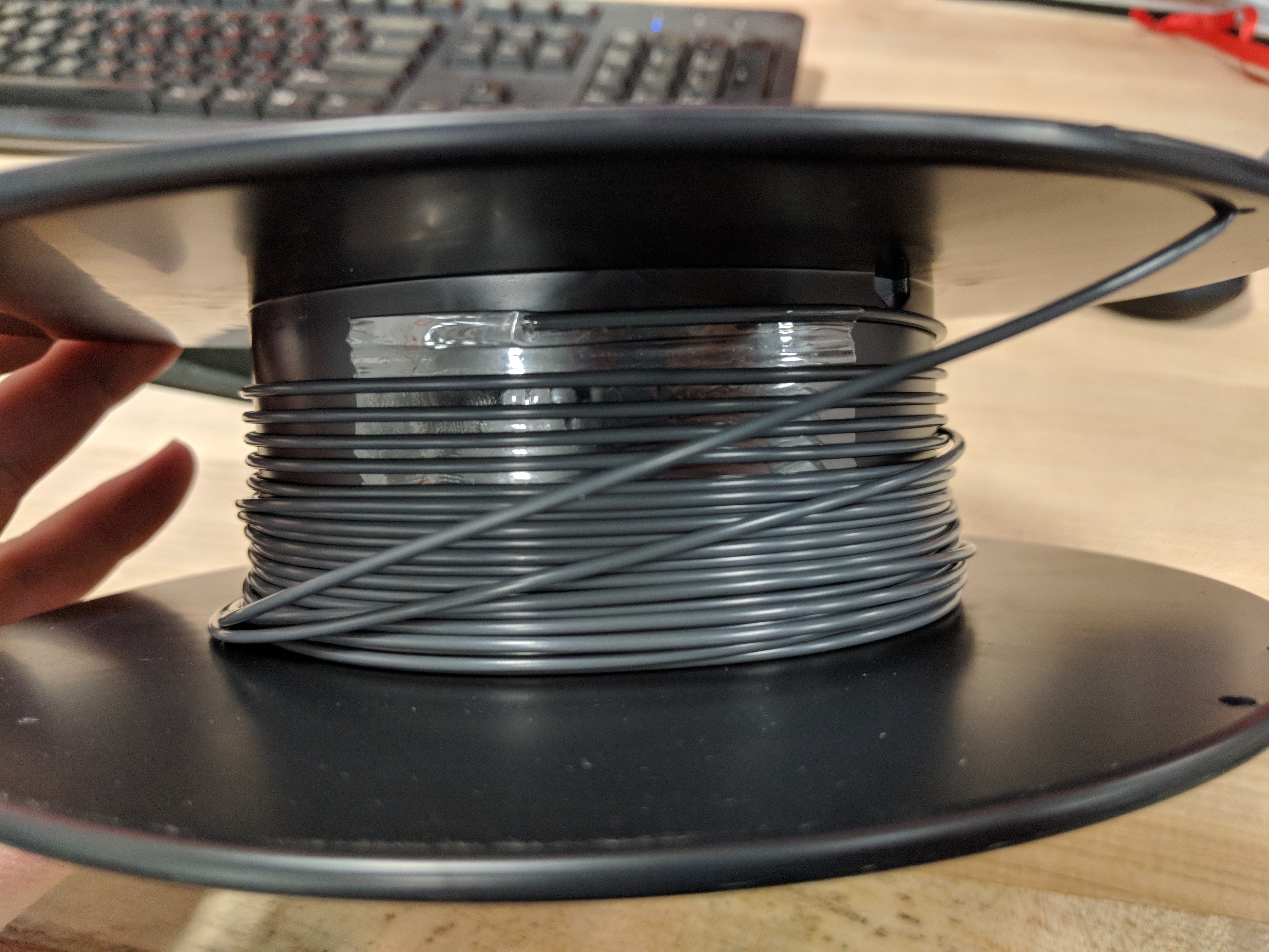

I've come across a number of spools that have the end of the filament
I’ve come across a number of spools that have the end of the filament taped to the barrel of the spool. I really wish that manufacturers weren’t doing this. It defeats my (and I suspect others) switches for filament detection by jamming the filament and never allowing the end of the filament to pass the switch. Which in turn makes it difficult to efficiently use spools up and print anything larger than a single spool.
Anyone have ideas to work around it? I know a pulse type sensor would be effective but I just got the switches implemented. I’d rather not have to worry about this and I can’t be re-spooling material just to remove this tape.
On the manufacturer’s side, if they put a small hole in the side of the spool by where they might tape it and stuck the filament out that hole and clamped it on the outside of the spool instead then there would be no tape needed and customers would be happier. As a big community with some high profile youtube content providers among us, we can probably get the filament makers to switch to that method or at least label the filament end holding method.
@NathanielStenzel I’ve seen many that do use that method and almost all spools I’ve seen have a hole for it too. I don’t see why some think the tape is a good idea. I’d really appreciate if this got some visibility to stop this practice.
Looking at the first photo this manufacturer already provides a hole in the core tube for the purpose.
I’ve noticed a few spools with no “centre” hole, so the only option would be some kind of tape, it’s a failure of the spool maker really. That said, when I do this for re-spooling small filament runs, I’ve seen that the extruder is usually strong enough to pull the filament loose from the tape…

The particular spool pictured is a Matterhackers Pro ABS. Several of them have it.
