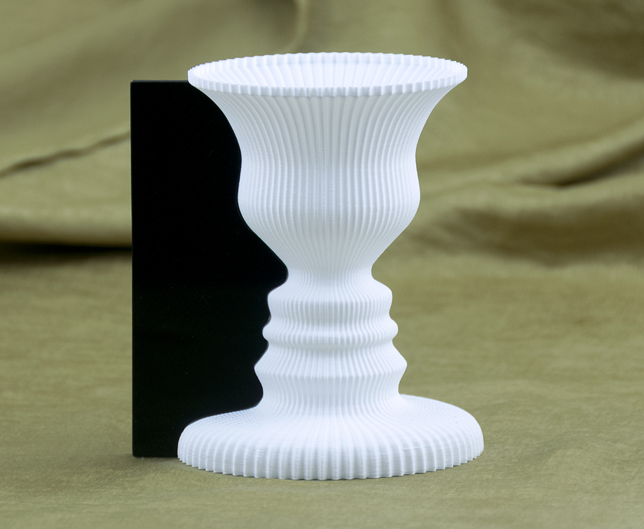

I’ve finally got my Victorian goblet / face illusion printing well. 120mm high.
I’m thinking about selling 3D prints of it on Etsy – anyone have any experience of selling prints on Etsy?
Worth a punt?

@Jim_Wygralak Rhinoceros 3D.
The print is tricky, as most of it looks better for being a spiral-vase print (so no layer shifts, a continuous spiral). But the bottom slopes in too fast to be a spiral print, so needs to be a conventional print.
Ultimately I sliced it twice (one spiral and one not) and then spliced the start of one gcode file and the rest of another together using a text editor

I’ve put it up on Etsy along with another design of mine – I’ll see what happens! https://www.etsy.com/uk/shop/StyleByMark
As there were no signs of the STL file being made available, I had a go at drawing this up myself after some internet image searching. I don’t think that my results are as good as those of @Mark_Wheadon - love the fluted sides on Mark’s - but I have shared my file on Thingiverse http://www.thingiverse.com/thing:1541337
Thank you Mark for the inspiration and idea - hope the ETSY shop is worthwhile. (I failed miserably when trying to combine GCode files for a standard version and a vase version - the angles on my thing are way too shallow for far too long).
I doubt the Etsy shop will do anything at all, but I’m giving it a go. Congrats on your design @Alan_Ryder – nice one.
