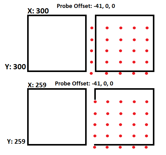

I’ve finally gotten all axises and probe working on my ramps + re-arm. However, I can not figure out how to get the probe when doing grid probing to stay inside the boundaries. I see that with a probe that is offset from the hotend that you apparently have to mess with the bed volume x/y to get it to not start probing off the left of the bed. So I’ve tried changing the size to accommodate the offset as you can see in from my beautiful mspaint skills. If I try to adjust the X much further it will not understand its hit the x-max and jam up but also I can not get it to move inward on the bed for the y to probe. I don’t think changing the offset of probe to a - would matter but I also don’t want to affect the mesh. Then from there I’m not sure how to give it the offset to move down to for printing. Link to my current config https://pastebin.com/fTifnfSE
Unless I can fake it using origins?

From the pictures it looks like the probe hits outside the printbed in Y? Is the probe in front of your hotend or does the Y axis home to a position where the hotend is outside the printbed?
If so, say that Y homes to a position 5mm in front of the printbed, i think you’d want to set alpha_min to -5. Same thing with X.
afaik,m you want your 0,0 X/Y to be in the lower left corner of the bed, not outside it. But i could be wrong. =)
Yeah its off because marlin when a probe is involved makes the probe act as the nozzle when homing. So a 0,0 with probe offset of -41 it puts the nozzle + 41 on the x axis where smoothie apparently doesn’t. The reason for grid probing is for variances in the build platform/glass itself. No surface is perfectly flat and the larger the surface the more chances there are for variance. I will be uploading a video shortly showing what it is doing.
