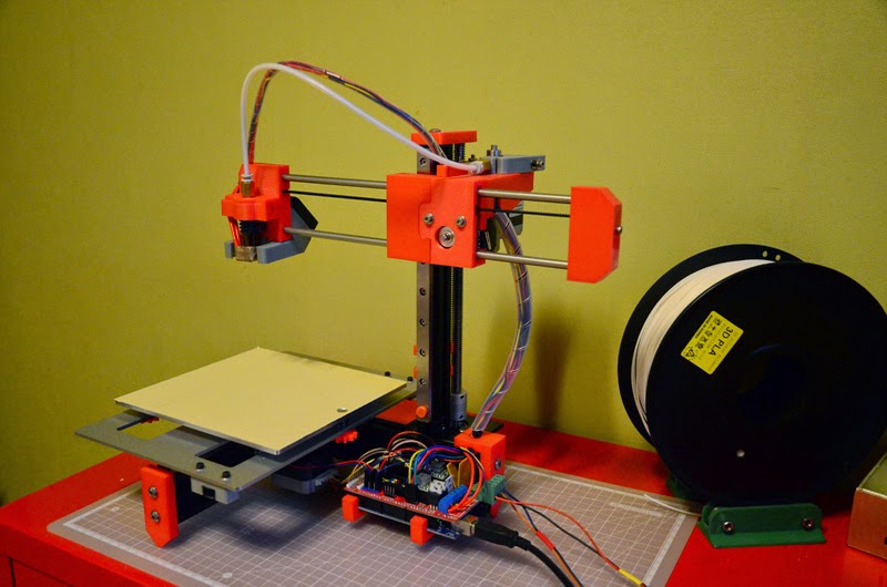

I’ve finished building my own 3D printer.
I named it as #RpStik (Rapid Prototype + Stick)
Still need more calibration for fine tuning.
And planning to add heated bed for ABS printing.
Any comment would be appreciated.
Thank you.

Very nice indeed. But if I were you, I would put extruder motor out of there, for example on the Z axis, not in the carriage, because the Z motor needs to move it (you would save it to move half kilo). Could you please post the Thingiverse or Github? Would love to print the extruder

@Javier_Prieto Thank you,
I, myself also have tried put extruder somewhere else because its too complicated and heavy. Unfortunately I couldn’t find a good place for it.
BTW, I’ll upload extruder file, maybe Thingiverse.
@Javier_Prieto You can download extruder files at http://www.thingiverse.com/thing:586521

mount it on the top of the post?
is this a kit you put together, or from scratch even better do you have a wiki or video on the build?
@Grady_Parker I designed from the scratch, It took me some months.
