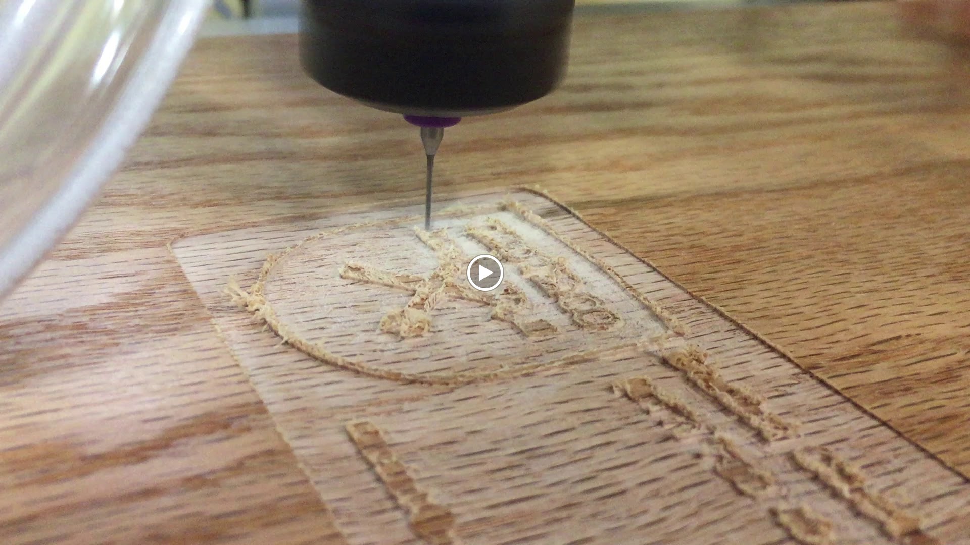

I’ve found the limitations of running chilipeppr entirely on a raspberry pi 3, however, my MacBook Air also fails with the same gcode. Disabling the 3D viewer while machining ensures no hiccups on bigger jobs. And isolating complex toolpaths to different sections (breaking it in to pieces) also seems to be the way to go. I designed a business card to mill out of 0.8mm aluminum sheet, this is my test run on some oak I have. This is the 3rd toolpath of 5. Everything works nicely!
