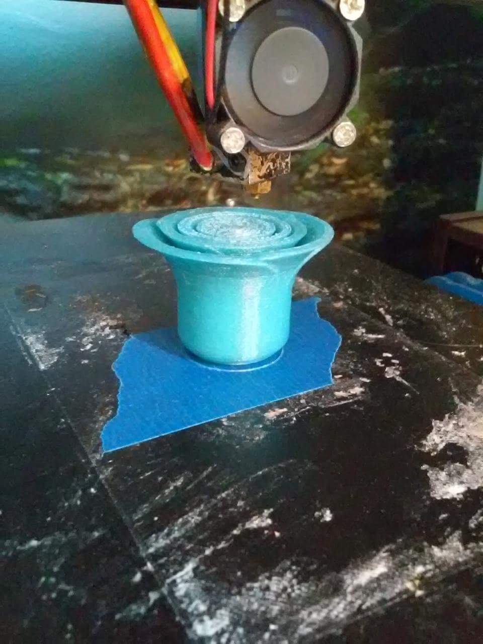

I’ve got a little problem, I was printing and the filament got stuck while I wasn’t watching. Is there anyway I can send a line of g-code to rewind 28 layers, or to jump to line 267123 in my code? I am using Repetier Host 1.6.0 with a Marlin RepRap printer (ThreeUp from Q3Dprinters)

I’ve followed all those instructions, I’m just worried about the printer starting with an E value of 7025.27070. Is there a way to set the E value to 7025.24265 (the position at the end of the previous step) before it runs the rest of the code? Or to set that as the home E value before it starts?
Also, somewhat unrelated, it warps when I start this print, because of the curve at the bottom of the object. How do I prevent that?

@Markus_Granberg ​​​​ I just looked it up on the RepRap wiki, It says G92. I’ll try the 7025.24265 in my code. Also, my extruder is currently sitting at Z=39.50. How do I tell Repetier host that? Is it something like G92 Z39.5? Also do I need to set absolute positioning or extruder in absolute mode at the beginning of the code? Also, is there a way to put a manual pause in your code?
Edit: added them in anyways. Hit print, I hope it works out.
Edit 2: it finished great.
