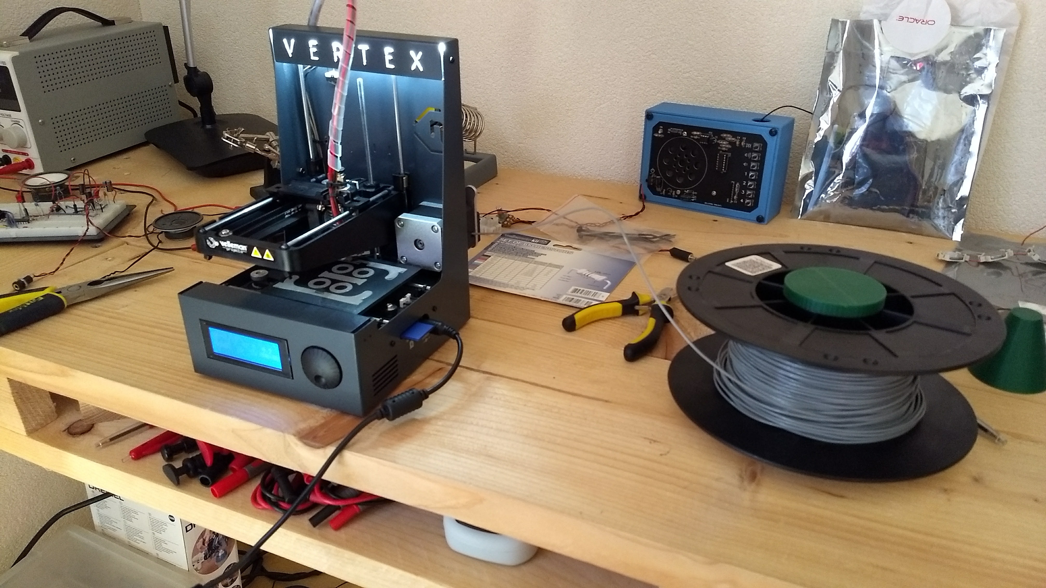

I've got a Vertex Nano K8600 for my birthday and just got it operating.
I’ve got a Vertex Nano K8600 for my birthday and just got it operating. It works fine but the software that comes with the Nano is a customized version of Repetier Host (Windows only). However I want to use Cura as slicer on my Mac. What is the best way to proceed? The K8600 settings are not available in Cura 3.0.

This picture shows the inside, and look! The usb port!
A shame they didn’t break it out, though.
But a simple cable would do the trick.
