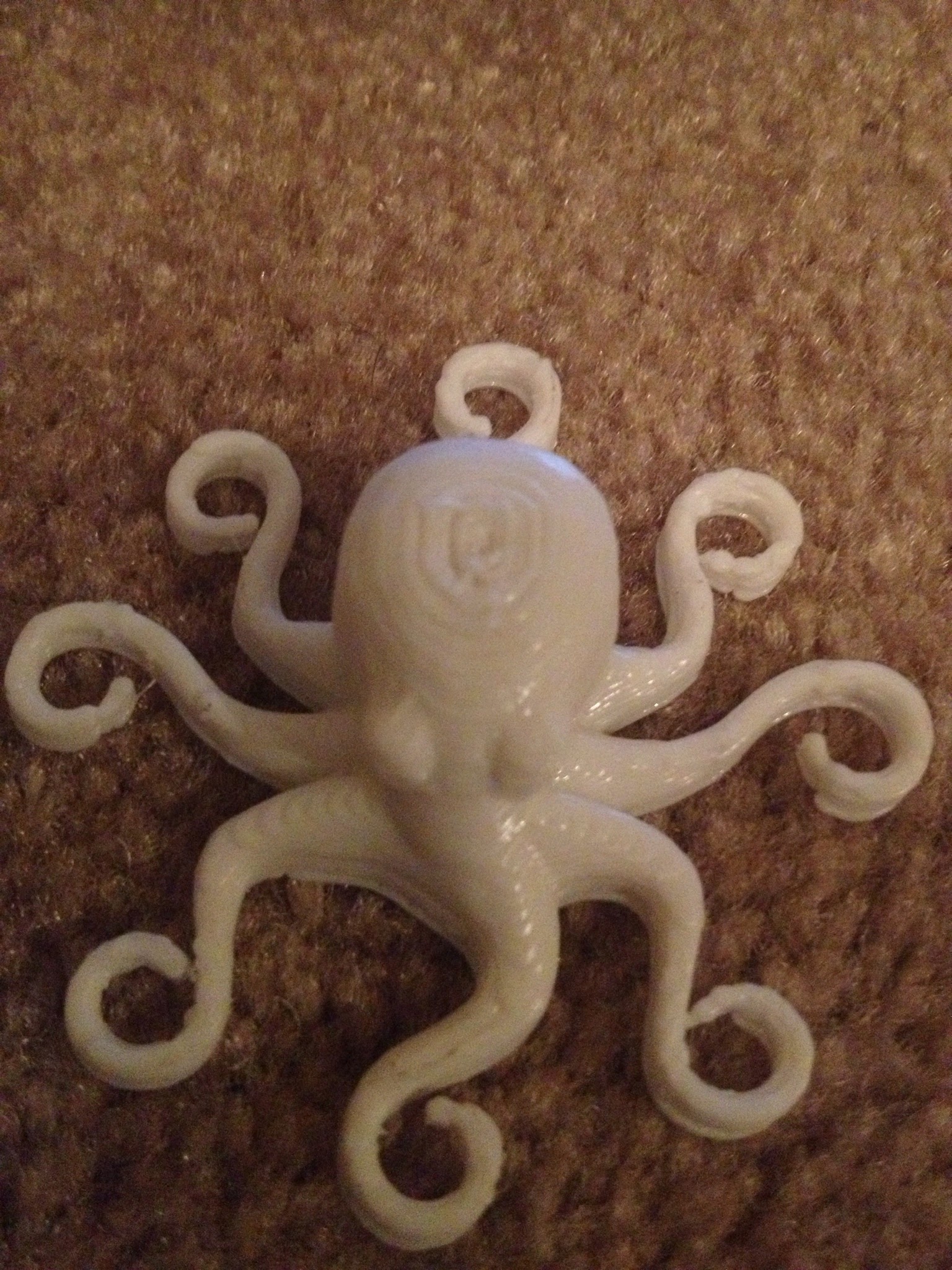

I've got better results from using Repetier :) I need to work on the
I’ve got better results from using Repetier :slight_smile:
I need to work on the detail and add a few more top layers.
Looks like you might be running your extruder a bit too hot - you can tweek flow rate print speed and temperature in repetier host with ease. Best to start with temperature and then worry about flow rates etc. Have you done any of the calibration walkthroughs?
Yh, I’ve gone through the calibration wiki, though not fully with the new print board. I’m waiting on some callipers so I can improve the flow rate. As for the temperature I’ve dropped the temp down to 185c. I’ll drop it down a bit more tonight :slight_smile:
