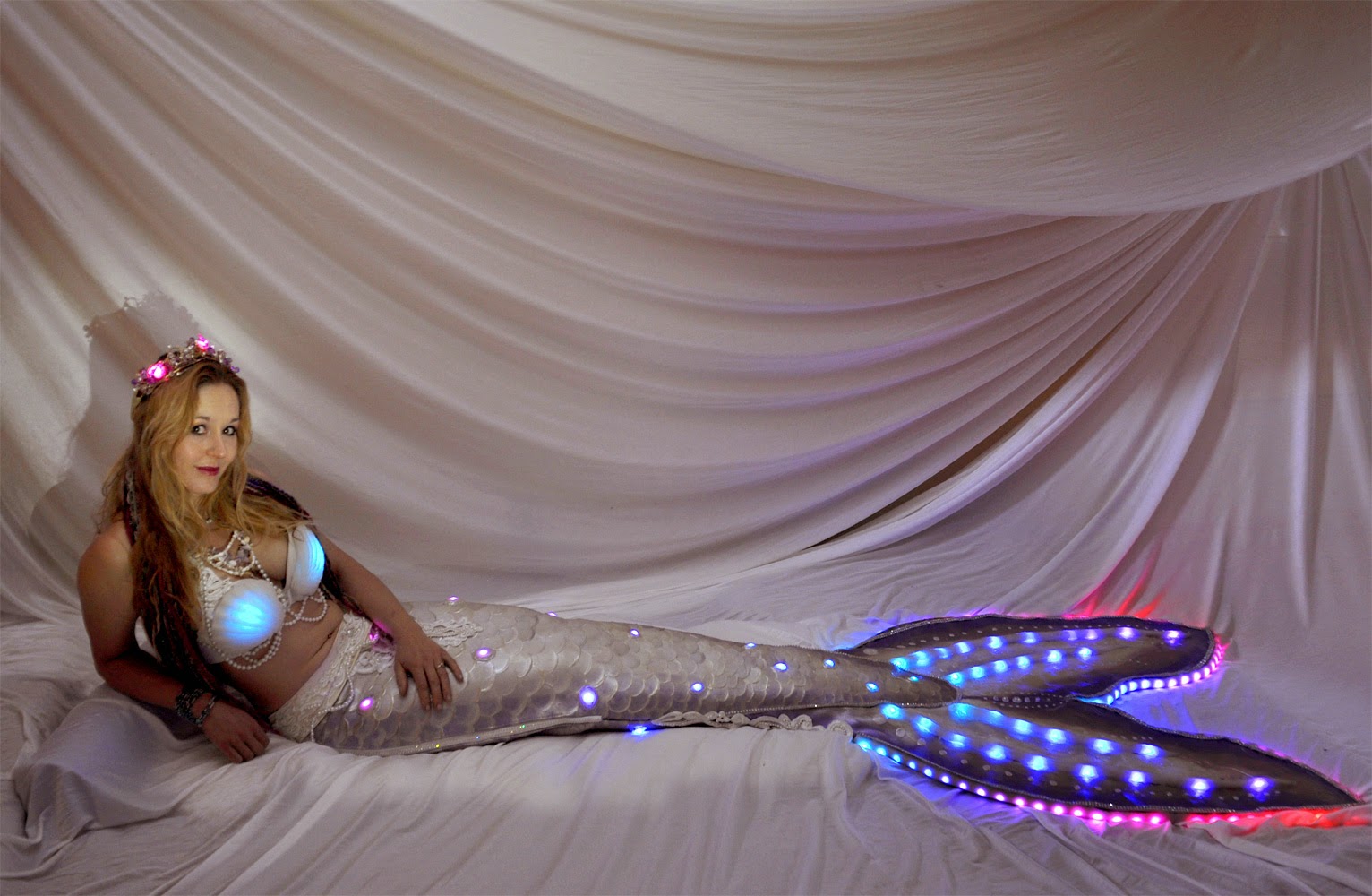

Here’s a photo of me wearing my project. Yes! It’s a light-up, swimmable mermaid tail. I am almost ready to do some photo shoots but I really need to be able to change modes without completely de-mermaid-ing.
Any and all advice and help is greatly appreciated!!! (I’m having no end of trouble with bluetooth on this project and am just about ready to rip all my fins out)

Share photos/videos of the tail in action when you get them! I’m really curious to see how the leds look/play under water.
And just because it needs saying, HOLY MARINE LIFE that’s a fantastic and just amazingly beautiful creation! And swimmable! Wow!

Thanks guys! Once I get a blog post out I will announce it “for real” and then would love all the link love and sharing I can get. Water testing it this week. Here is hoping I do not electrocute myself. :slight_smile:
