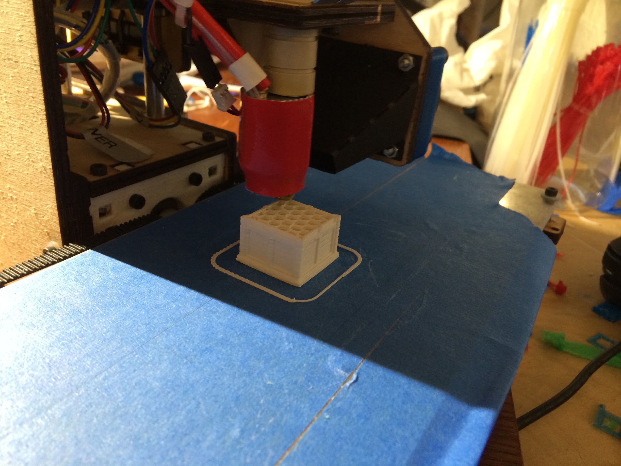

I’ve had my @Printrbot Simple for over a month now, and I’m still very happy with it. The XL upgrade prints great, specially after adding GT2 belts. My experience with different filaments, not so awesome.
White PLA from Printrbot: Solid material, probably the strongest stuff I have. Seems to want to print a higher temps, 210 to 215. Will jam if left on the large spool it came with and placed on the Simple Tower, but runs fine when re-spooled to the small spool that comes with the tower.
Translucent Blue PLA from some dude on ebay: The cheapest, yet oddly easiest material to work with. When spooled onto the small wood spool, prints clean every time. A little more brittle then the Printrbot filament but still quite strong.
Green PLA from “JustPLA” on Amazon. Picked it up because it was free shipping with Amazon Prime. Is the worst of the filaments I’ve used. Will jam nearly every time, even on short jobs. On the spool it’s very soft, after printing it’s super brittle. Only one thing I’ve printed with it has not cracked (A small knob)
Mustard Yellow PLA that came with the printer from Printrbot; Not great stuff, the white and blue both outperform it. Feels rough to the touch and globs up on printing a lot more, but hey it was nice of them to include it so you can get printing right away.
I have some more of the ebay filament on order to see how consistent it is, trying black this time to see how it goes
